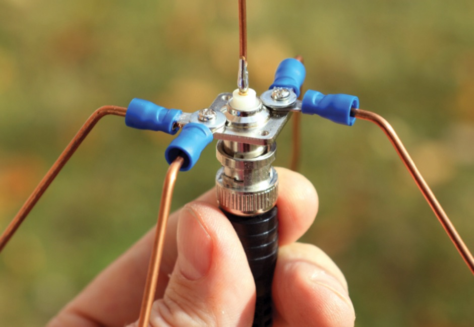

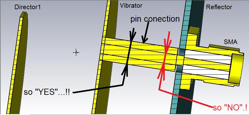

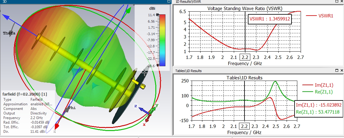

There is a so-called author on the internet who seems to want to dyce the spider antenna for wifi ... !!!
He said..."Spider" does not work! (Ground Plane balun need!)
What do you say, he's right ... ???

wow Juri is a tuff guy
it looks that he like to simulate antennas
it looks to me like  he is fake expert
but some of simulations looking nice

It's been used from more than a 100 YEARS...
But then again the most used antenna is like a quarter wave + balun or half wave alltogether
https://martybugs.net/wireless/images/ducky_inside.jpg

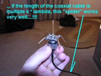

I don't say that, i never build such antenna but i used
small pin antenna which comes with wifi card and that one work
but work better if we add some reflector.
