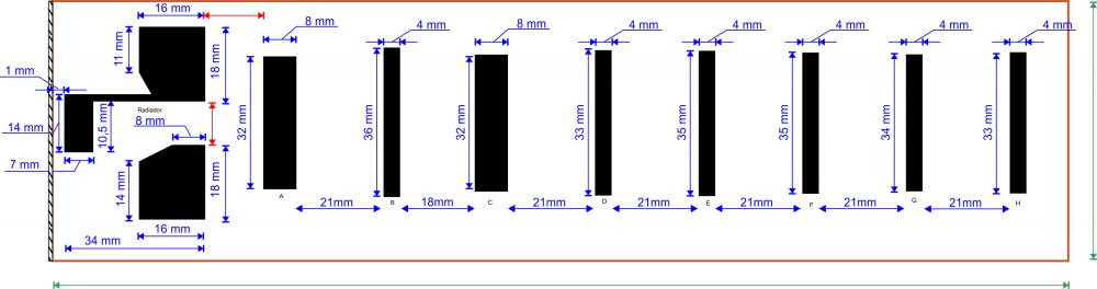

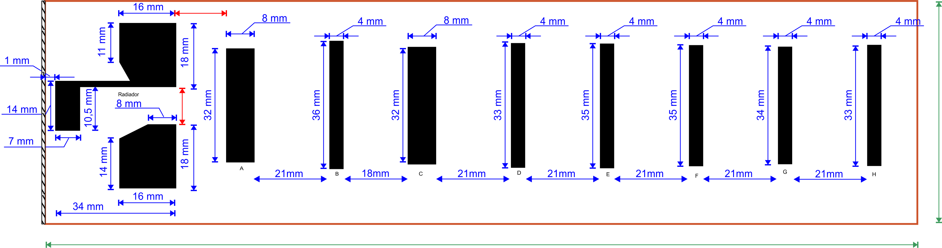

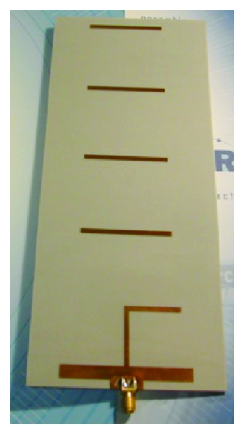

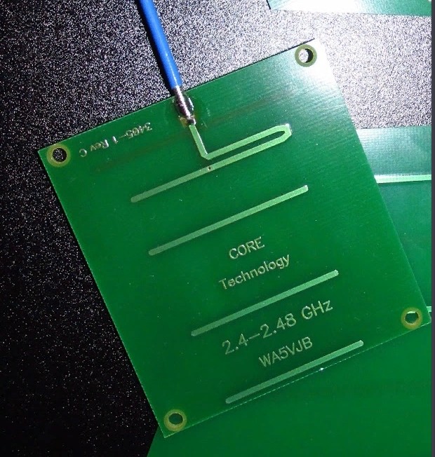

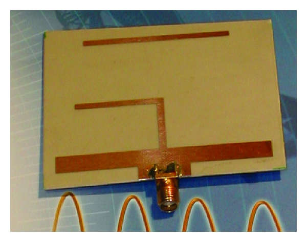

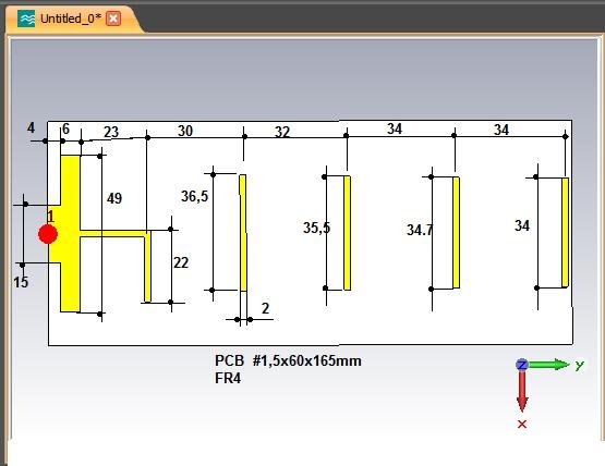

PCB Yagi Antenna
This yagi style printed circuit board antenna gives great performance from 2400 to 2450 MHz. This range is commonly used for wireless systems 802.11b/g, RFID systems, satellite dish antennas, dish feeds, and beacons. This can also be easily applied to other hobbyist applications in this range.
,,, a user on this forum(ct2iok) is interested in this yagi antenna..

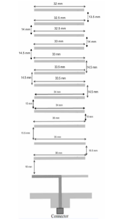

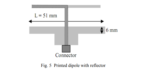

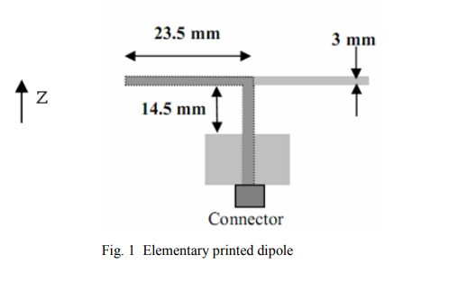

DESIGN OF Printed Dipole with Reflector and Multi Directors
PID991189.pdf
