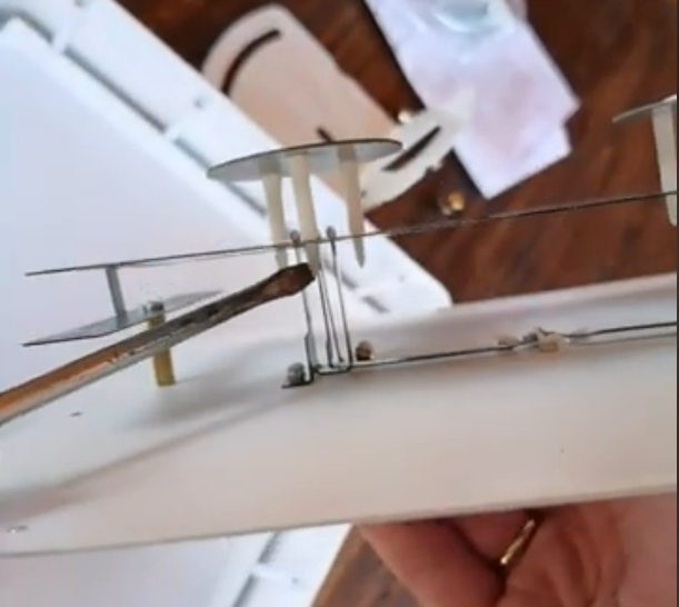

This antenna is similar to this one...
,,,but of poorer quality...!!!!

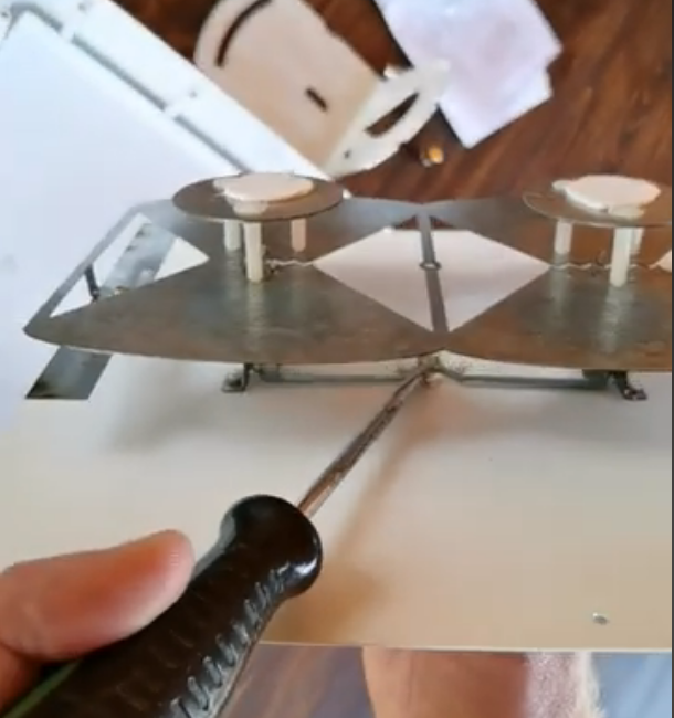

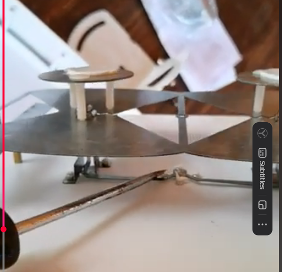

Double Bow Tie ,  How is fed ? (the coax braid to reflector UNBALANCED)
,,,,okay, now you can do a simulation...!!!
LOL ! NO WAY (no my cup of tea) but that Russian feed POSTS YOU KNOW IT WELL...(LPDA or Vivaldi would be easier to do and tune)
I think this is the adaptation more clearly seen....

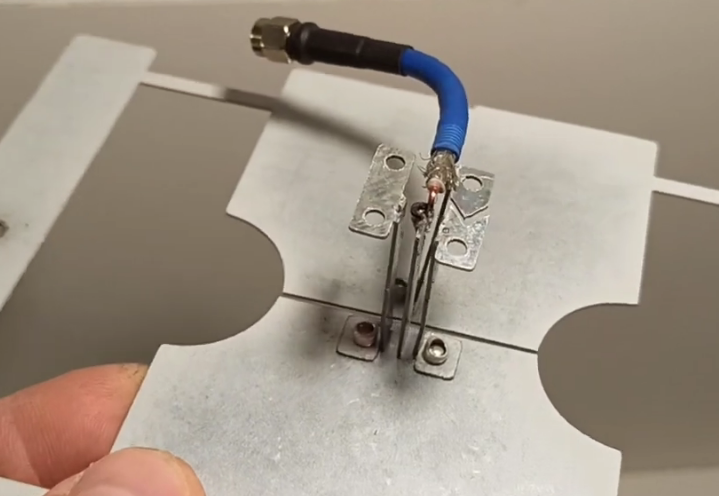

They keep the 50 ohms shield with the 3 posts surrounding the inner wire...? maybe there is impedance matching there or is it a BALUN...?
also there's a CUT by the shield of coax...
