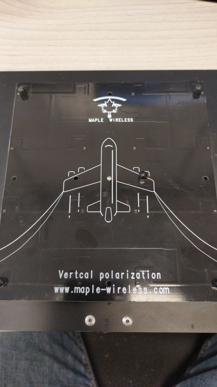

Aksonx2, I see you have this MAPLE antenna, can you give some dimensions....???
With pleasure :)))) write what dimensions you need to take off . I can disassemble the antenna. By the way, the Chinese produce them in 3 versions . Which one do you need? :))))))

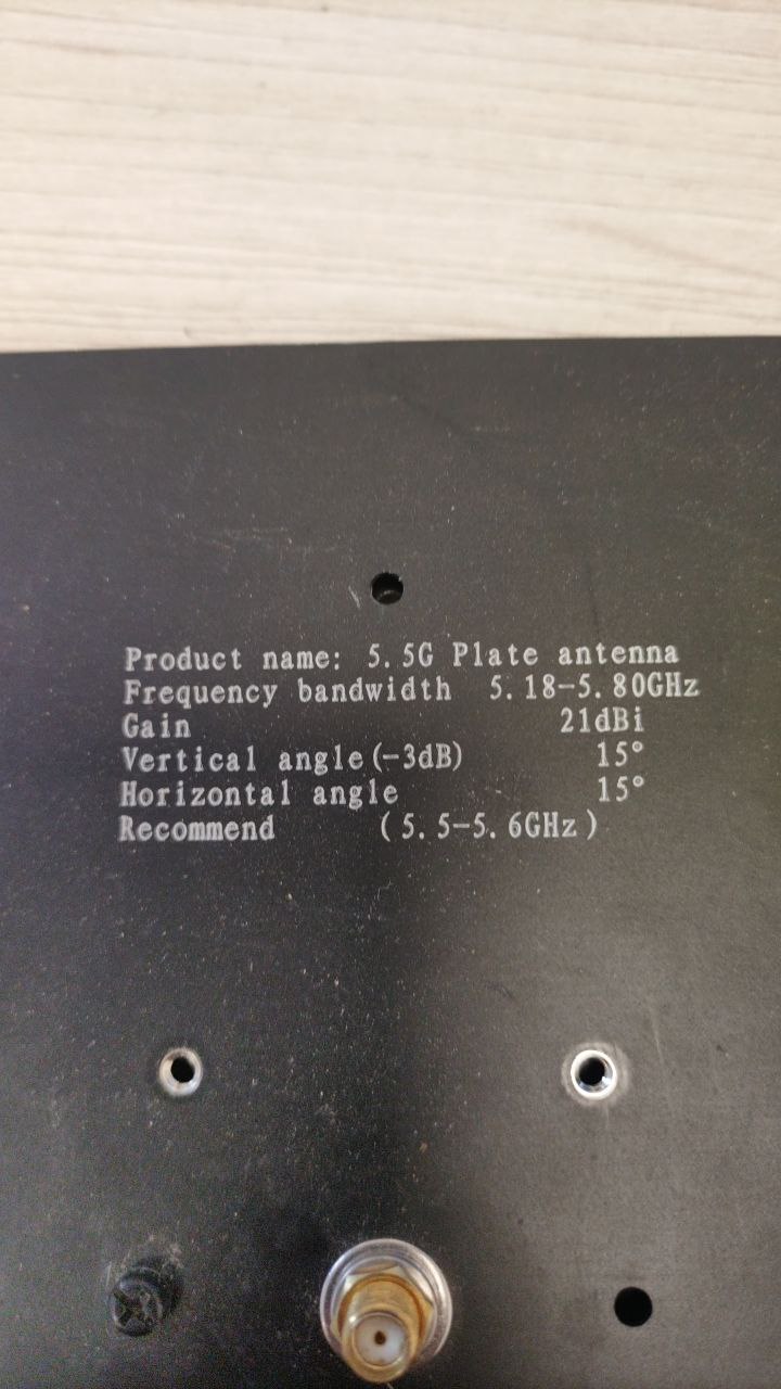

4,5-5.4 GHz ; 21 dBi....all dimensions...!!!!
I'll try to do everything by Monday.

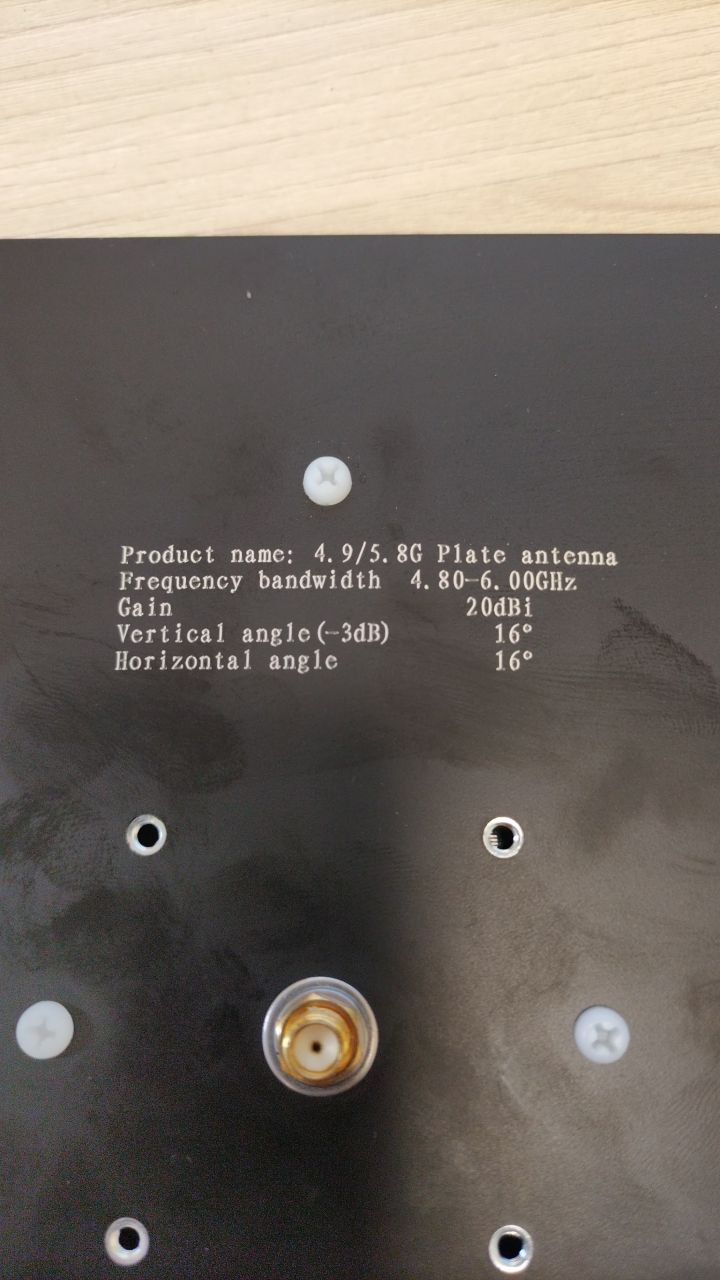

Maple Wireless 5.5 g , Gain 20 dBi
The antenna is a little loose ...

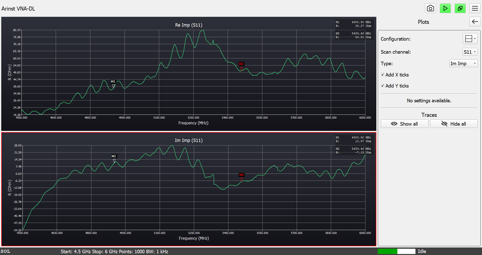

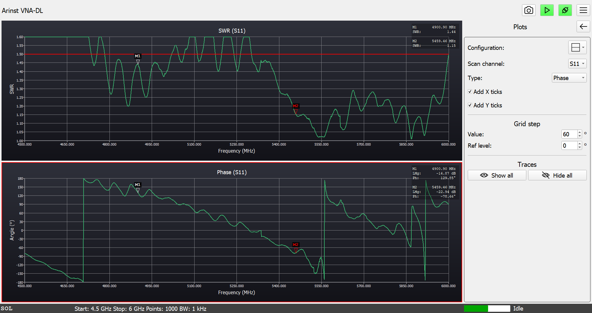

,,,here Harry36 did some simulations....
is it regular FR4 ...how good is the S11...?
looks like Fiberglass...and how THICK...?

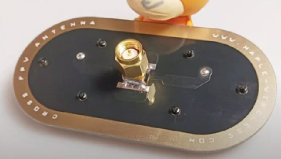

On 22.08.2025 at 6:39 PM, Admin said:
,,,okay,thanks buddy....!!!
it will take some time. I disassembled the antenna, and there are elements on both sides of the textolite
