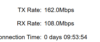

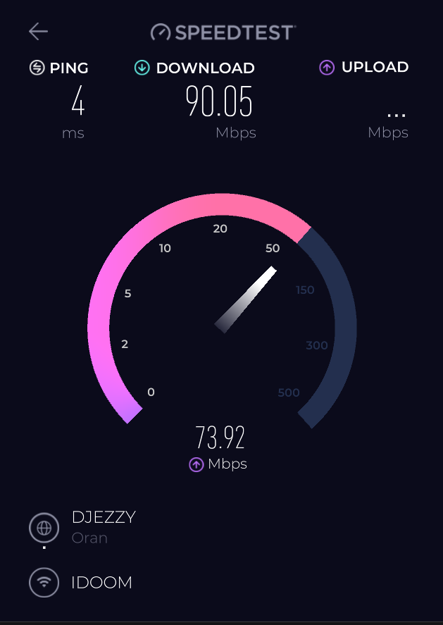

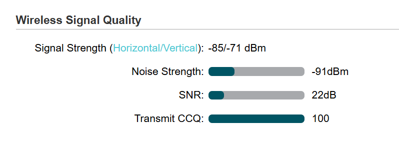

@clanon I took a gamble and decided to buy the TP-Link CPE 710 — it's a 5GHz-only single unit, and I'm using it as a Wi-Fi receiver from about 100 meters away. The source is a Huawei router with a 5dBi omni antenna, but there's a medium-sized building made of bricks and concrete blocking the line of sight (so, no LOS).
Despite that, the good news is I managed to establish a stable connection, getting speeds between 40 and 100 Mbps depending on the time of day. I also made some tweaks on both ends: selected the best-performing Wi-Fi channel on the router, enabled Guard Interval and WMM, and set the channel width to 40 MHz for better performance.

also been gaming on it daily, no packet loss, or ping spikes, or connection drops nothing at all, might be picking up a strong reflection am planning to mod the CPE 710 dish for even higher snr around 25DB, any idea how to do that, would making extra panels from alluminum help?

i mean 100 mbps on 5ghz with a building as an obstacle with no LOS and only one unit of CPE 710 is already impressive

After extensive testing, I found that using an 80 MHz channel gives me significantly higher RX and TX rates, while 20 MHz performs the worst — possibly due to signal reflections or interference. Also, disabling WMM drastically reduces the overall speed so now using 80MHz channel is giving me 150 mbps down which is more than enough for me, i hope that doesnt change and it stays that way
