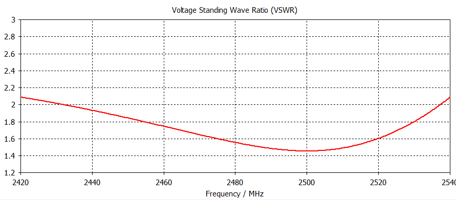

thanks, finally after some attempts it worked perfectly vswr <1.5, forgot to take photos

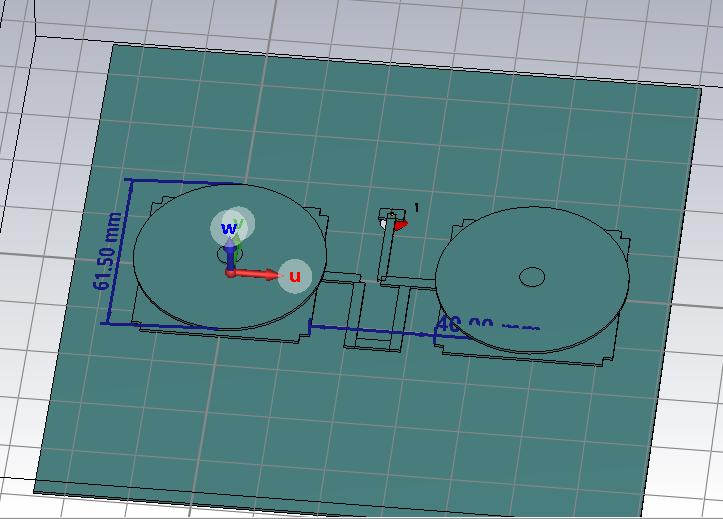

Dear friend, please tell me, why did u connect port at this point of the conductor line?
In original antenna thare is othere decision.
