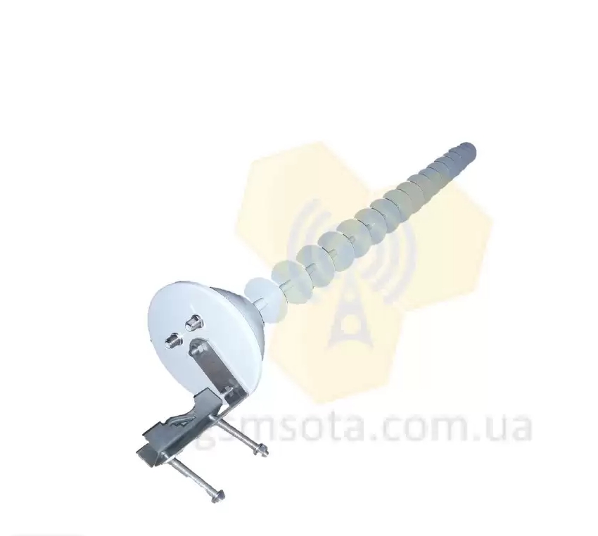

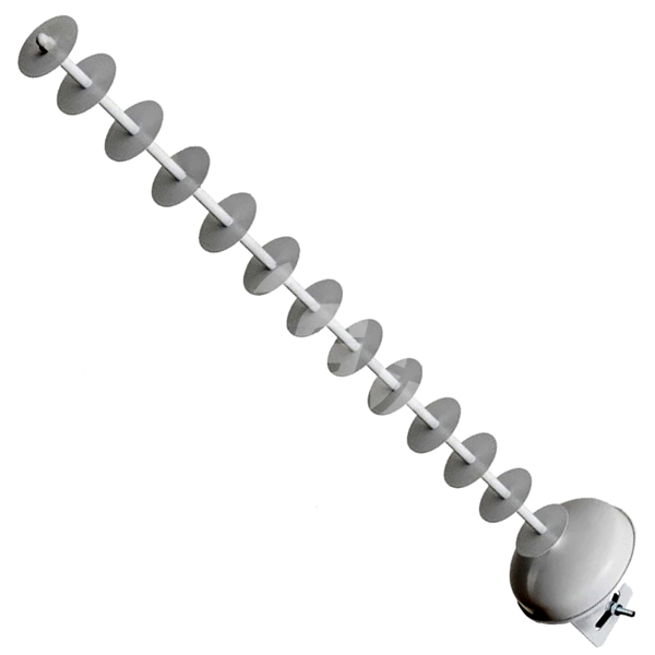

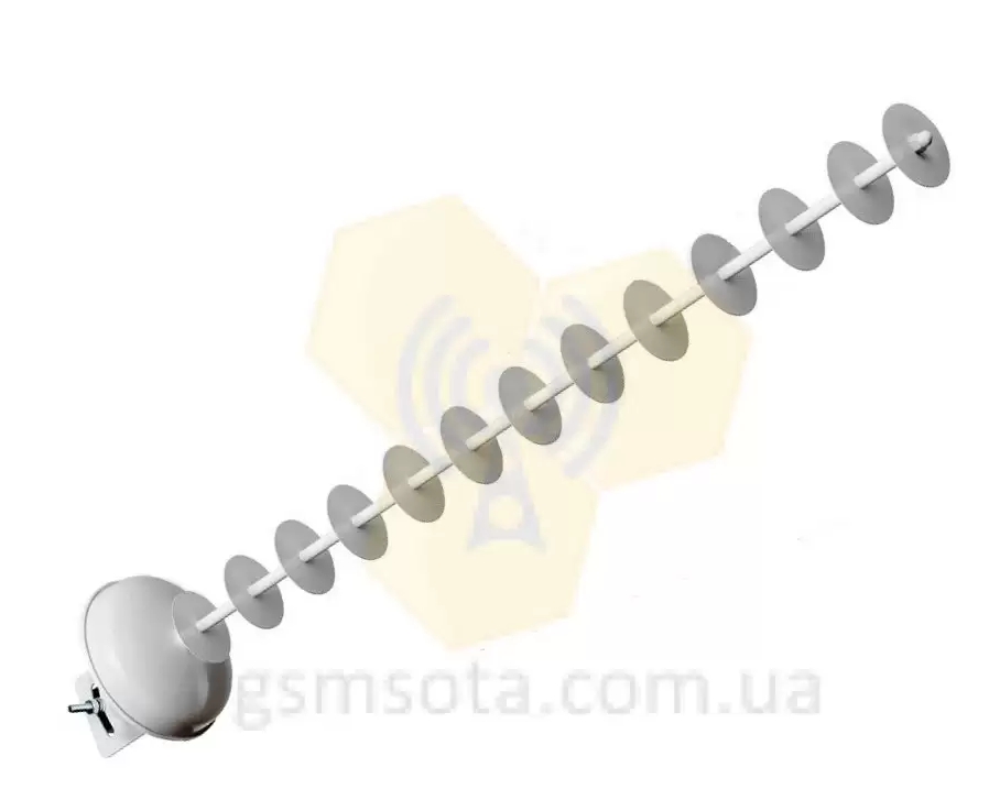

3G-4G antenna Strela MIMO 1700-2170 Mhz 20 dB
3G-4G Antenna Strela MIMO 20 dB for Kyivstar Vodafone Lifecell
Many owners of UMTS and LTE MIMO modems use poor-quality Internet and I believe that this is how it should be, that nothing can be done, that everything depends on the mobile operator. Probably not everyone knows that using the Internet using a USB modem, your modem has a connector for connecting a special 3G UMTS amplifying antenna.
The antenna is used to improve the quality of 3G / 4G signal of the cellular network of Kyivstar, Vodafone, Lifecell operators. TriMob. The device has two connectors for connecting to a modem using MIMO technology. Data transmission and reception are performed by separate elements, which allows you to increase the speed of mobile Internet. With the help of this antenna, you can significantly strengthen the received signal, improve the quality of communication in places with uncertain reception, at a distance of up to 10-20 km from the base station. The antenna has a convenient mount on a pipe or mast and an exit under the F-connector for easy connection.
3G UMTS 2100 + 4G LTE 1800 MIMO
3G / 4G UMTS HSDPA LTE 20 dB antenna is designed for self-installation. It has small dimensions and low weight. Install it only on the street by directing it to the operator's base station. You can also use the installation services of our company's engineers for the installation and adjustment of antennas.
Strela 3G / 4G Directional mimo Antenna Specifications:
Frequency range, MHz: 1700-2170
Number of elements: 17

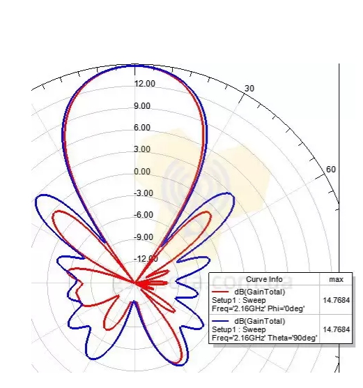

Radiation pattern width: 19/19 degrees vertically and horizontally
Gain: Port 1-20 dBi, Port 2-20 dBi
Polarization: Vertical + horizontal
Max. input power, W: 30
Input impedance, Ohms: 50

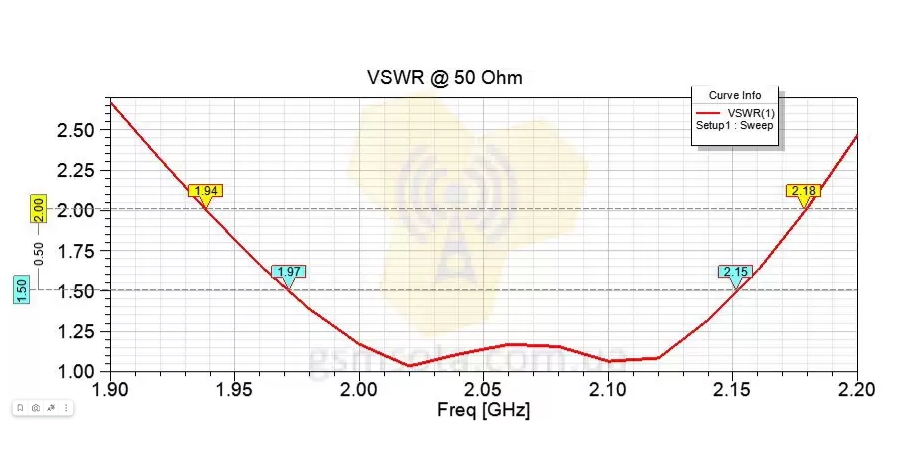

Standing wave ratio: 1.4 (no more than 1.8)
Lightning protection integrated in the antenna
Mast diameter, mm: 25-50
Weight-0.7 kg
Dimensions: 1000x130x130 mm
Permissible wind speed, m / sec: 40
Head and traverse material: Aluminum, Galvanized steel, ABS plastic
Bracket: galvanized steel

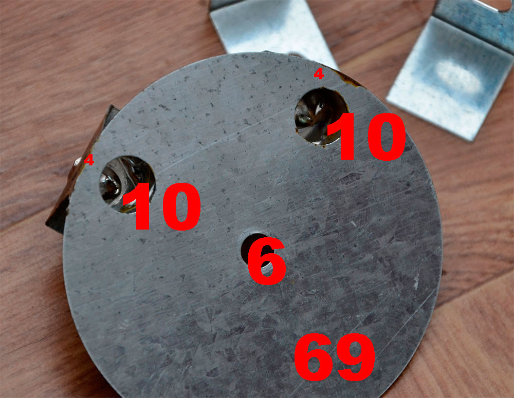

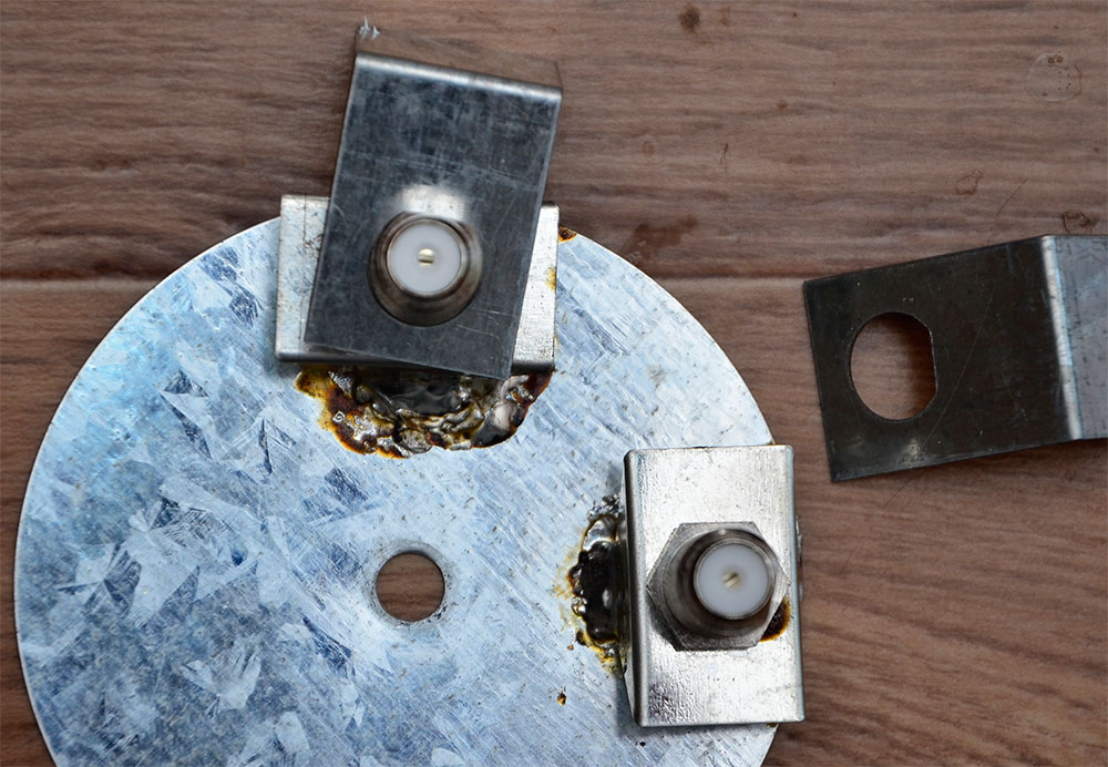

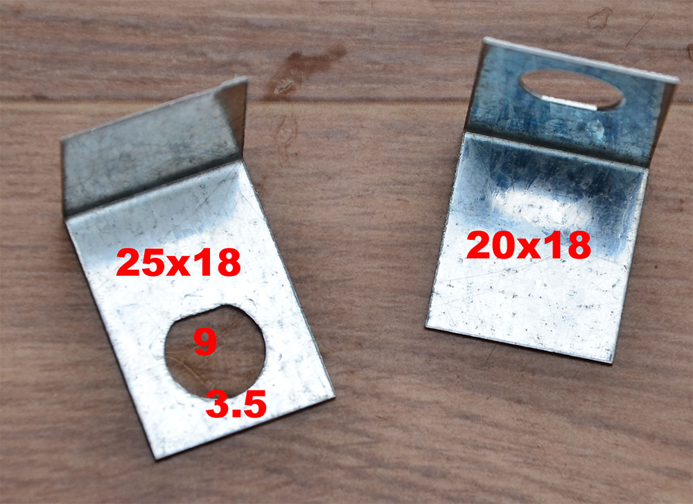

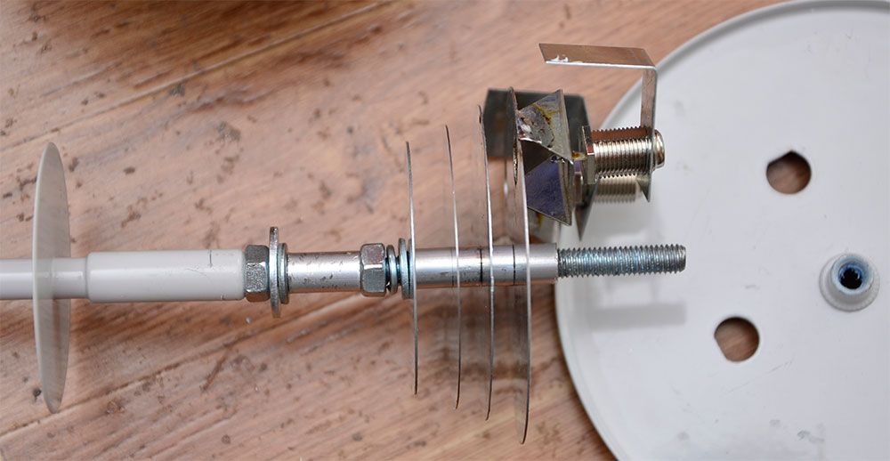

napravlennaja-3g-4g-umts-lte-antenna-strelarnet(mimo2x2)-1700-2170-mgc-s-usileniem-20db-600x600_0.png
Thank you so much, what is the material, dimensions, thickness of the disks? The spacing between them? thickness of the body holding the whole assembly?
