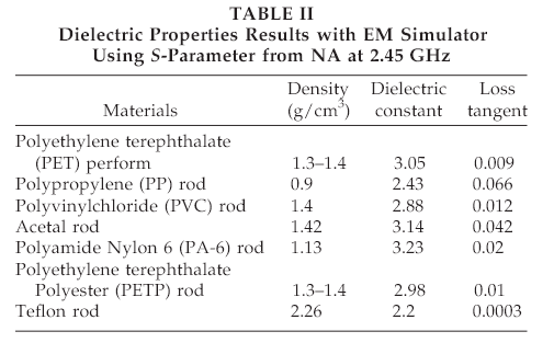

I've found that PET is good choice - is that true ?

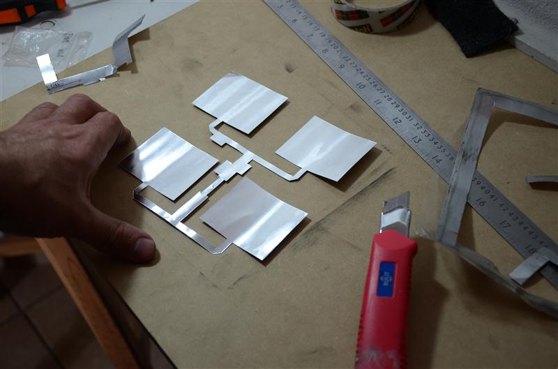

The best material for the construction of the antennas is the sheet, thickness of 0.15-0.5mm
This is from the sheet of aluminum tin cans boxes
,,, good, show me such a material in practice ... !!!
For the helix antennas does not really matter dielectric material, but I think the best is Teflon , Polystyrene and the Air
you have right. But sometimes we can't use them.
example:
a lot of PMMA.

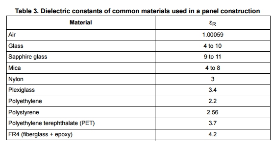

It's obvious that will shift antenna characteristics. But I suppose that materials will have also impact on other properties of antenna.
PMMA
Organic glass (plexiglass), or polymethyl methacrylate (PMMA)...???
The dielectric constant of PMMA is around 4.9....very bad
 How To Build this Brother ?
How about stainless steel sir?, since it cheaper.
,,,it"s good too...!!!
