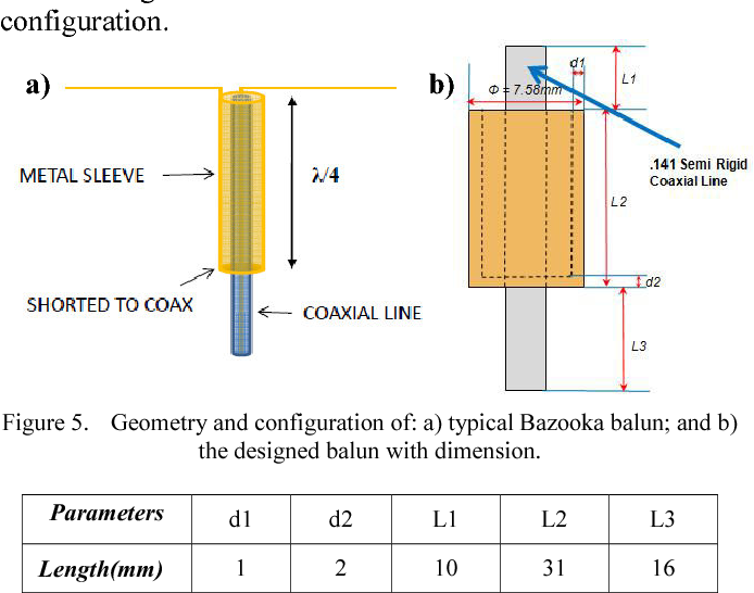

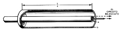

Thats stubm balun, it may be directed downward or upward, I have no idea what the difference in operation is. Only klow that is to phase shift. (My version in previous page was tunable)
Edited by eco32
Open side pointing up (the direction of the Energy you DON'T want coming through the Shield of Coaxial) imho The confussion comes from the rubber duckie pointing DOWN (open end) cause it is ACTING as a Quarter wave and ground plane to obtain a HALF WAVE dipole...
,,,something like this...
