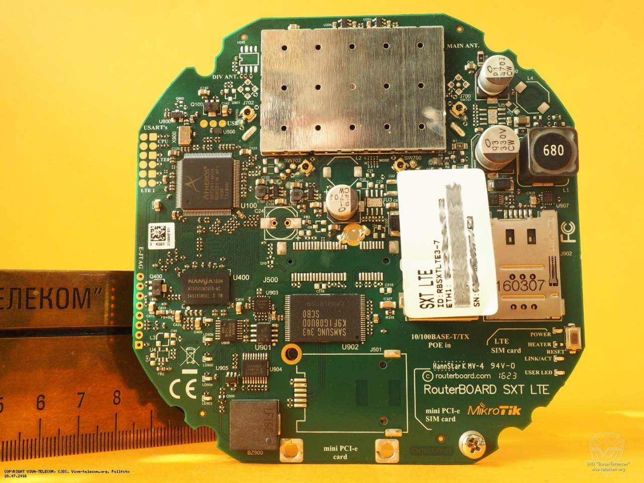

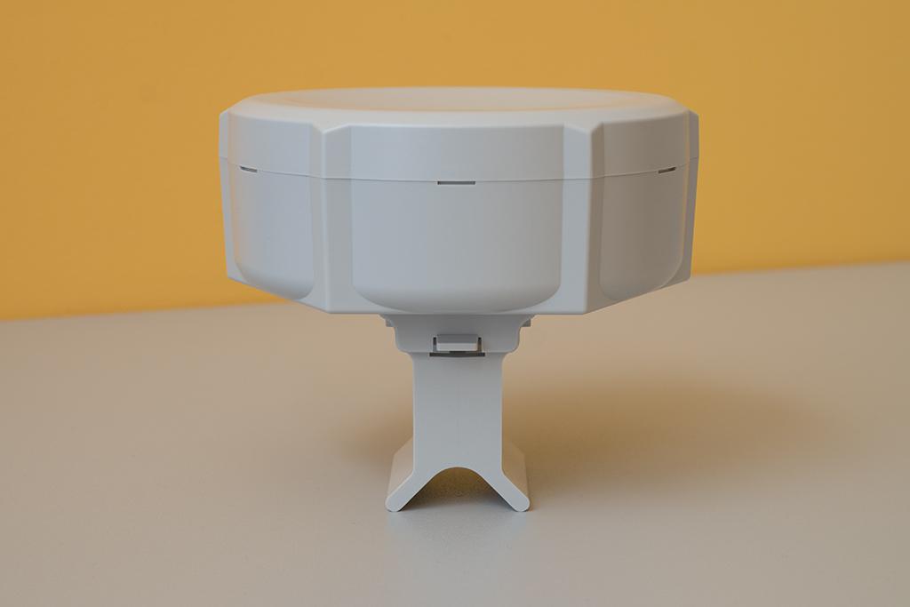

MikroTik SXT-LTE from CJSC "Viva-Telecom"
Wireless access point MikroTik SXT LTE does not work in the 802.11 standard, and is equipped with LTE-modem with a directional antenna dual channel to work in LTE networks of mobile operators at speeds of up to 100Mbit.
Maximum download speed up to 100 Mbps, and the return of up to 50 Mbps.
SXT supports the most popular LTE band FDD - LTE 3 (1800 MHz) and 7 (2600 MHz). Has mini-SIM slot support 2G/4G network.

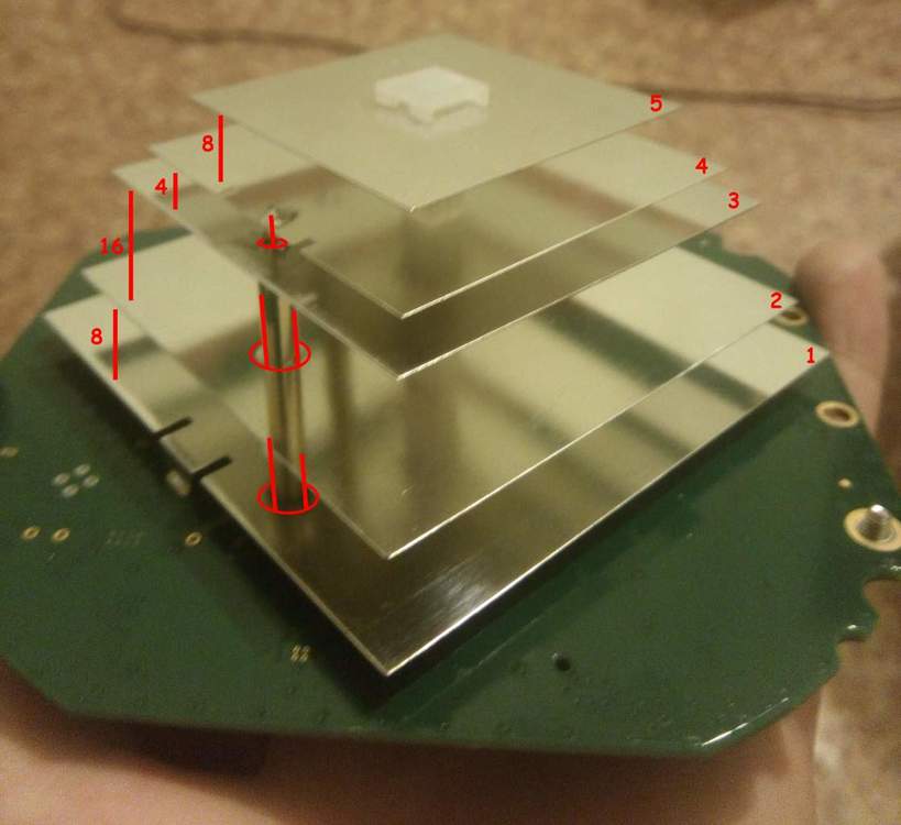

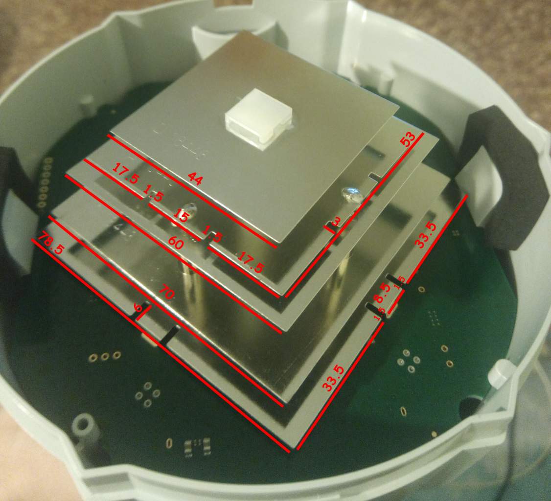

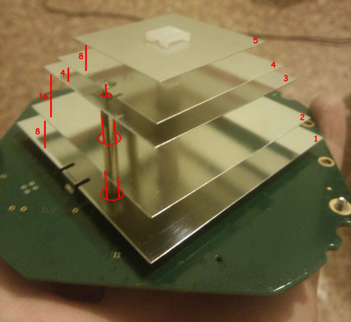

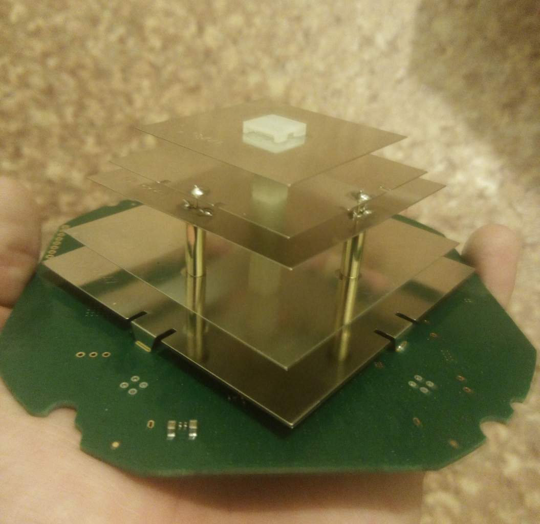

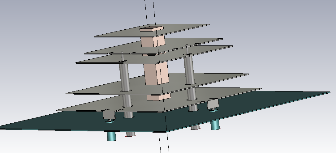

The dimensions of the antenna
,,,yes...!!!
,,,you want 2400MHz + 2600MHz...???
,,,or only for 2,4GHz...???
may 2400 - 2480? its interesting to try another model..but please measure 0.5mm and 1mm thickness material,,thanks admin..

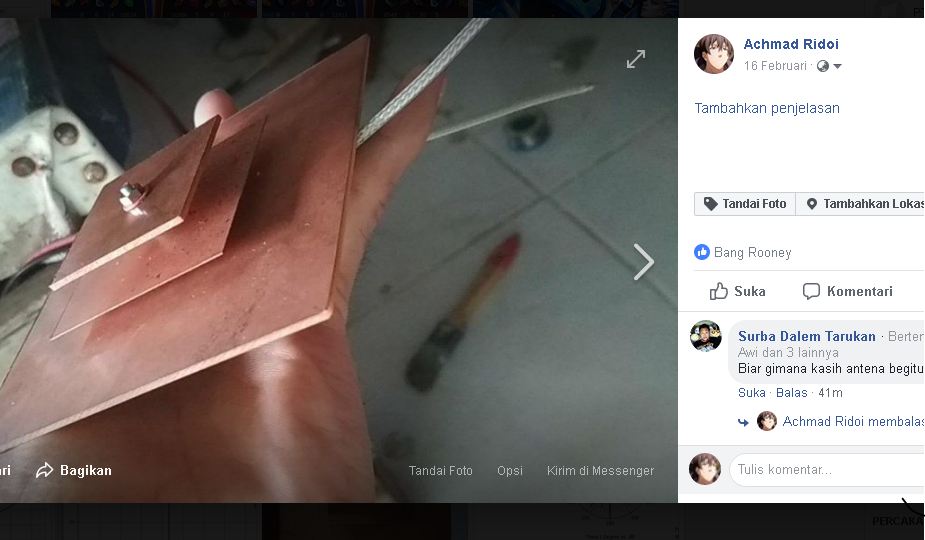

mimo kotak products that I sell on facebook :D
