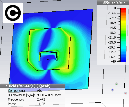

the U-slot variant with truncated corners
Very interesting Could you please share realized gain vs frequency? S11 too? I see you are exciting two orthogonal modes and breaking simetry with truncated corners and U-slot. What is the benefit of this? increase the bandwidth? Improve the axial ratio?
