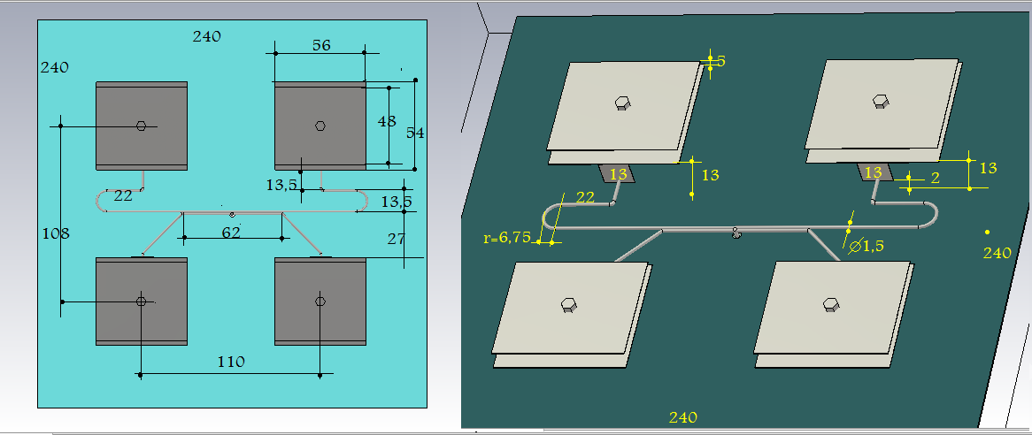

On 3/11/2019 at 10:25 PM, Admin said:hello JOMY. I read a sea of literature about this antenna, at 2630 there are different sizes everywhere, is your antenna ready for manufacturing? I asked you for a connector, I want to order several on ALI. I want to try to make two antennas. A cannon and a patch that we discussed and you gave the dimensions. And yet I don't really understand the place of powering on the patch. Probably stupid !!!
Jomy sorry !!!!!!!!!!!! I copy, because the workshop is located far out of town, the Internet is very bad there. Drawings are needed for manufacturing! But I realized, I will draw with a pencil by hand.
36 minutes ago, vova.gumerov said:jomy привет, вы можете попросить подробные размеры этого объединенного патча и можно ли его использовать под повторителем..???
Jomy можешь подробнее показать место запитки и какой лучше использоать разьём для 2630МГц Я прошу вид сбоку, извени я только перехожу на этот тип антенн!!!
Jomy, you can show in more detail the place of power supply and which one is better to use a plug for 2630MHz I ask for a side view, I'm sorry I'm just switching to this type of antennas !!!

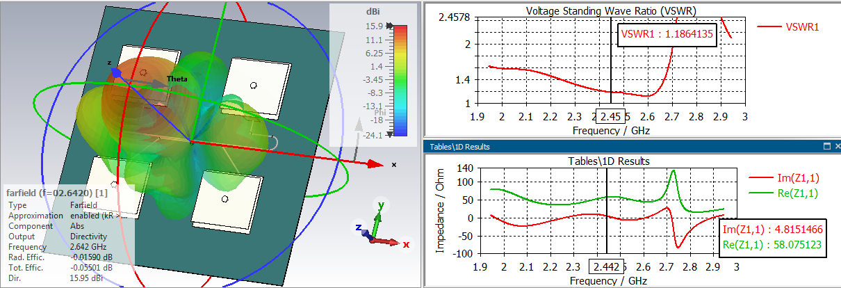

Спасибо, сверил размеры, пересчёт всё правильно!!!!
Thank you, checked the dimensions, recalculation is all right !!!!

Hi jomi. the height of the patch is 13 mm, and the connection of the patch with the feed line is also 13 mm. The feed line is 2 mm from the reflector. Is the patch at an angle?
