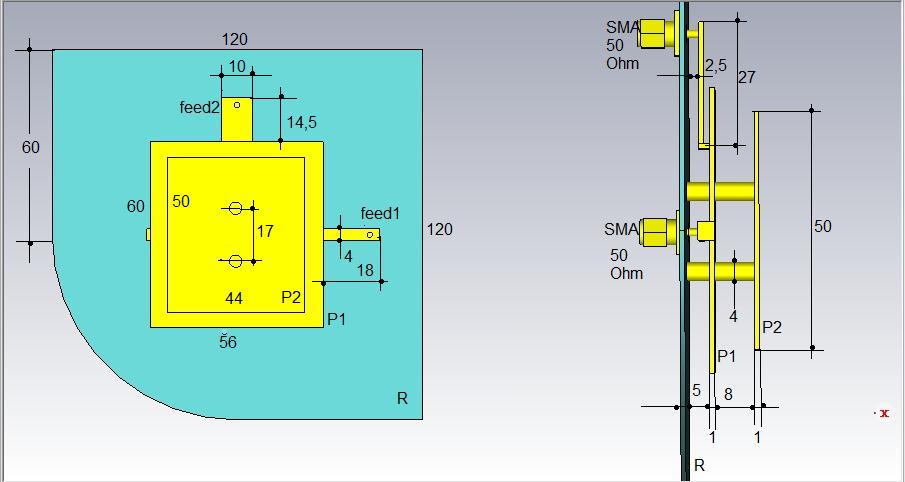

,,,,this is *gbr file for pcb FR4...

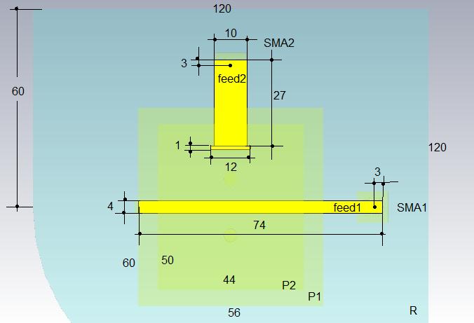

Test comparison of antennas for the Internet from 'Anteks' & 'Gellan'....
Yes, it seems that I had a mistake in the design, now it works,,,
,,here it"s the modified CST*file....!!!!

3 minutes ago, RC-Concepts said:After PCB A and B are aligned, you mean VSWR is still 6.74 in your simulation? This is strange.
,,,, yes, you're right, that's what I ask myself, why ... ??? !!!
My simulation above is compliant...!!!

I tried to do an optimized simulation of this type of antenna, in a half part...
