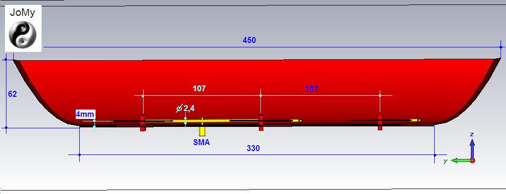

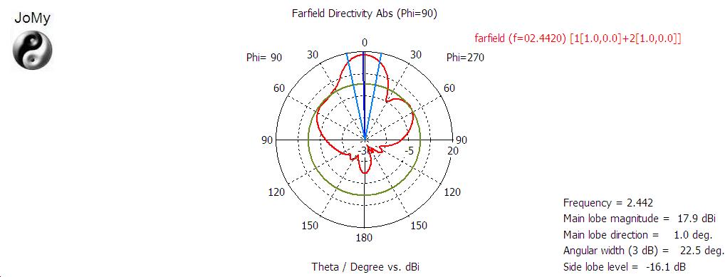

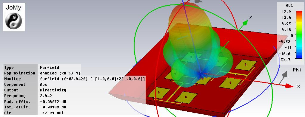

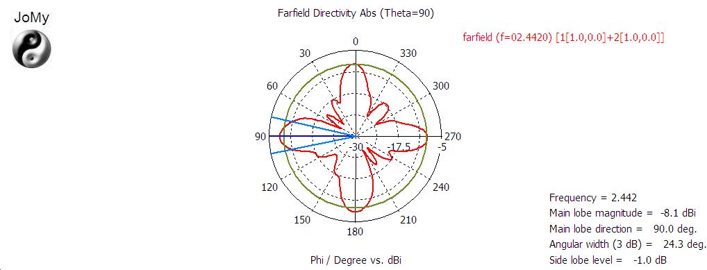

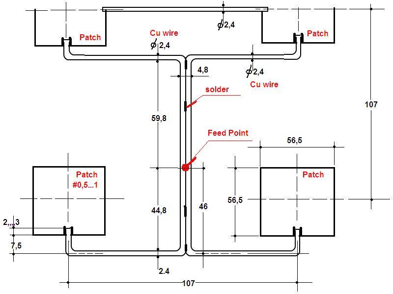

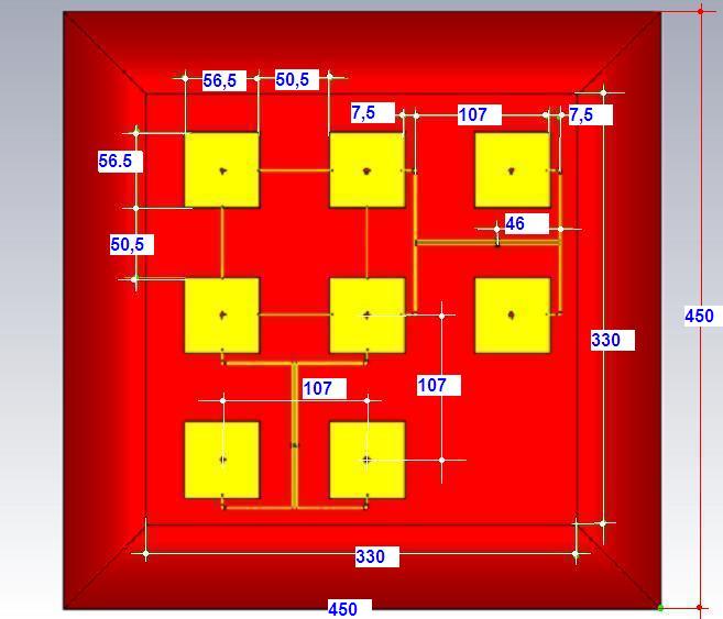

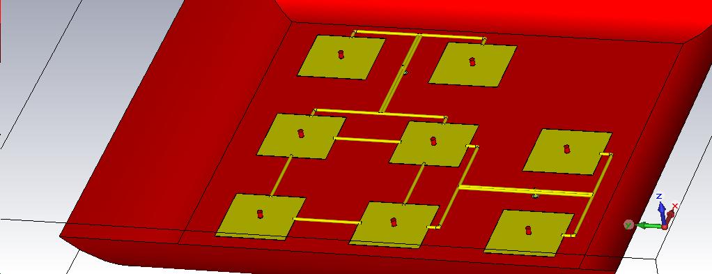

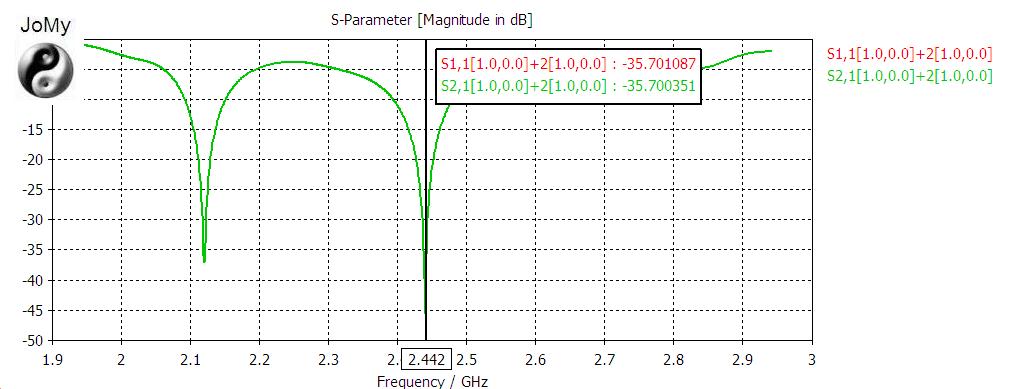

Panel 3x3 MiMo Antenna
Operating in the 2,4GHz band, the antenna panel integrates a state-of-the-art, dual-polarized smart antenna that offers blazingly fast and highly reliability connectivity across long distances
The reflector is provided with CPC (Compound Parabolic Curve) walls.
4 people like this

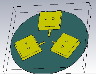

nice brother
but what I'm looking for is with three feed points
is there anything like that?
I want to try making an antenna for the WR940N router
Edited by acri
Something like that....???!!
,,, but I think I have to open another topic with this type of antenna...!!!
