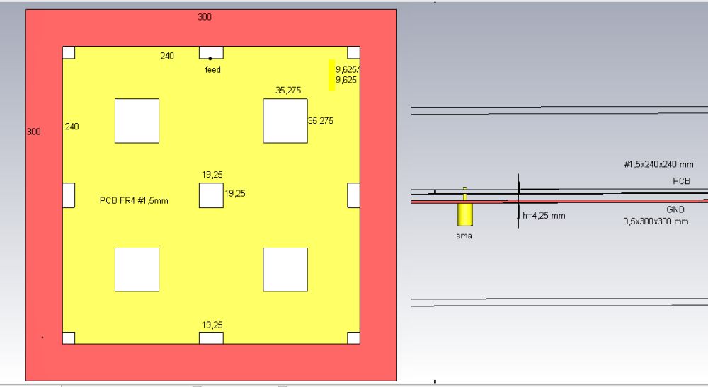

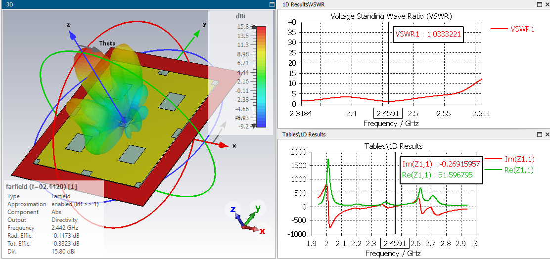

SLOTTED (LEAKY-WAVE) ANTENNA
 Can be made of a pcb board and a metal reflector
What size is that pannel...? average...
 I do not know, I do not remember, this type of antenna is my oldest simulation of several years ago...!!!
I still think the PCB is 250x250mm.
,,,but  I will resume this simulation with leaky-wave antenna...!!!
