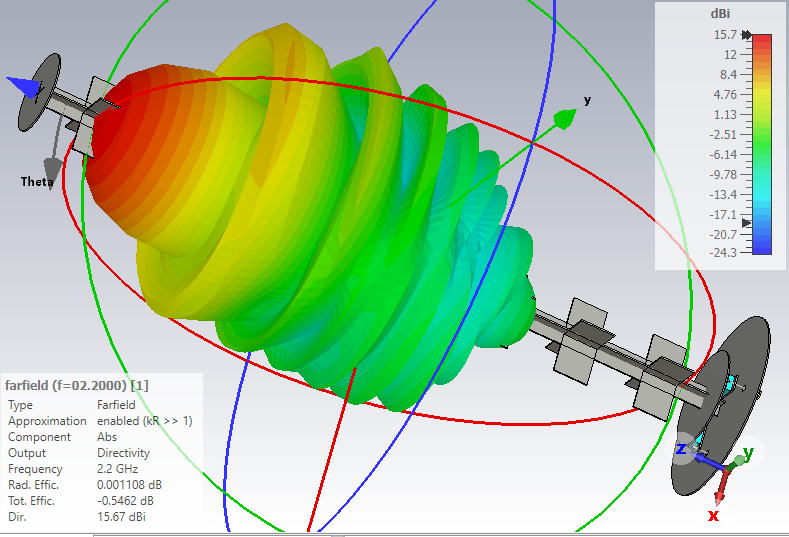

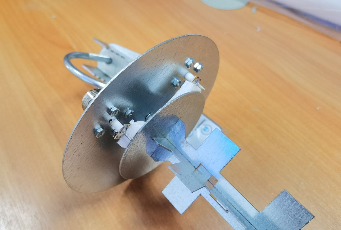

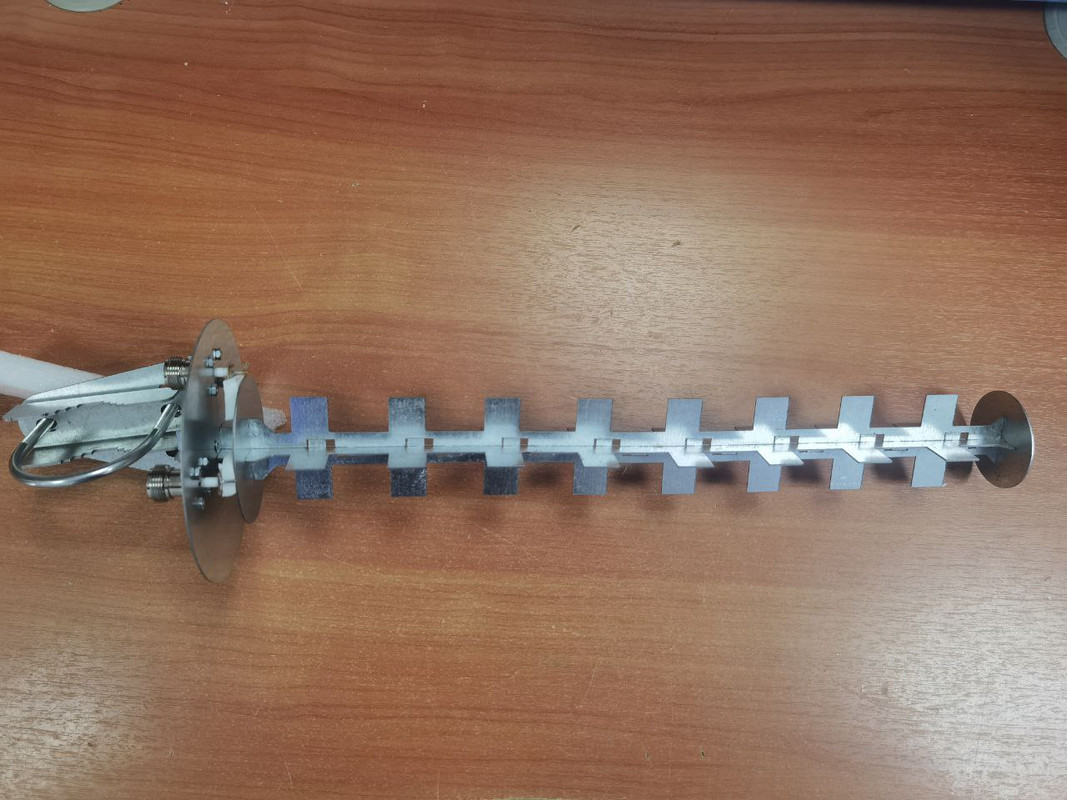

The antenna is interesting but it still needs work, it doesn't have a large bandwidth,,,only 1,8----2,2 GHz
you COULD try with triangular elements

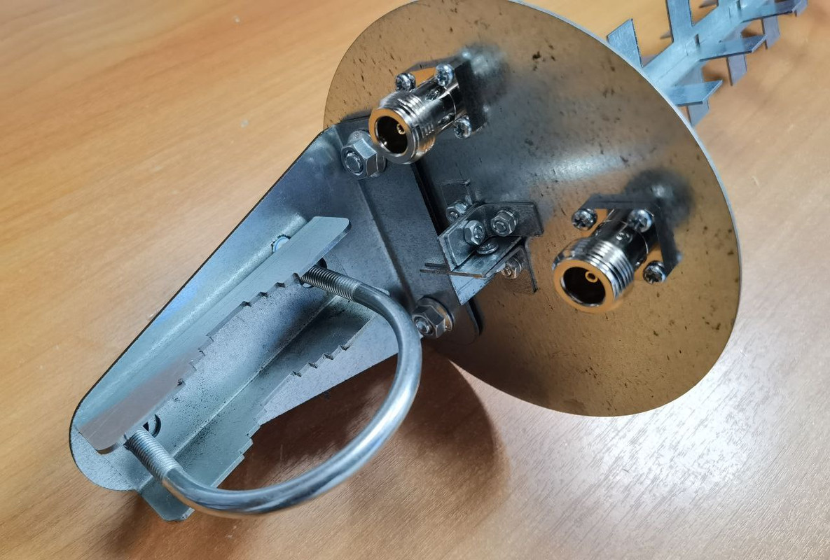

they build it like that (two flat stamped sheets) for easy manufacture and cheap...
Yes, I think it's a good idea, but there are problems with impedance matching....!!!
,,,maybe a circular parasitic patch should be added after the radiator...!!!

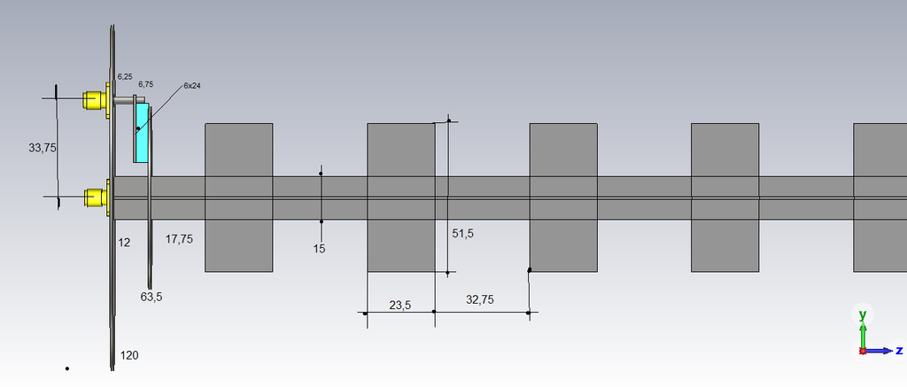

Jomy ,could you post the aproxímate dimensions...I wanna try and make it wider bandwidth)
I don't know if this can help you.....
I'm goin to replace the squares with bowtie triangles to check if it gets better...

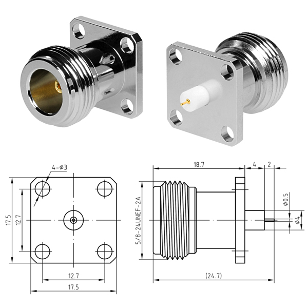

do you have the N type connector posted somewhere...?

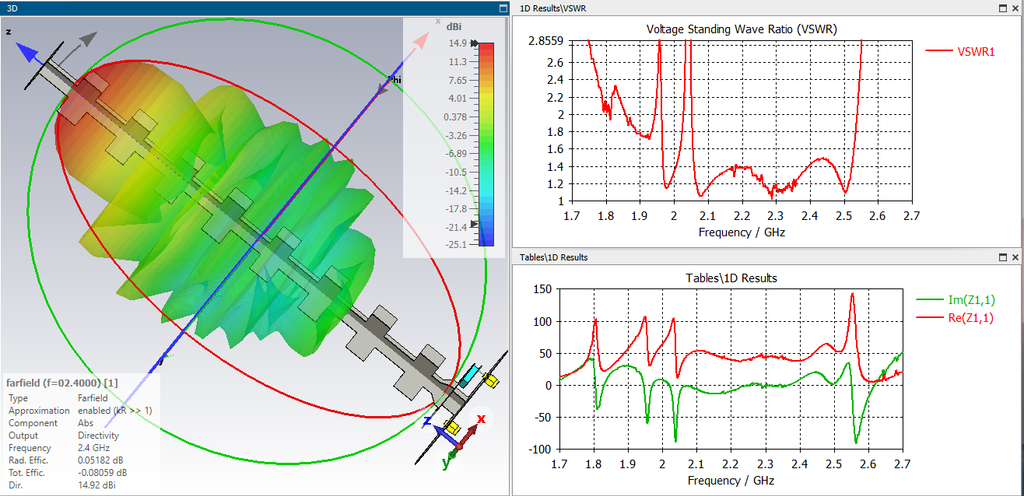

Company published VSWR

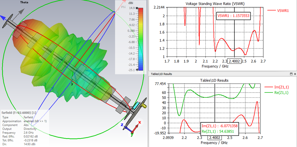

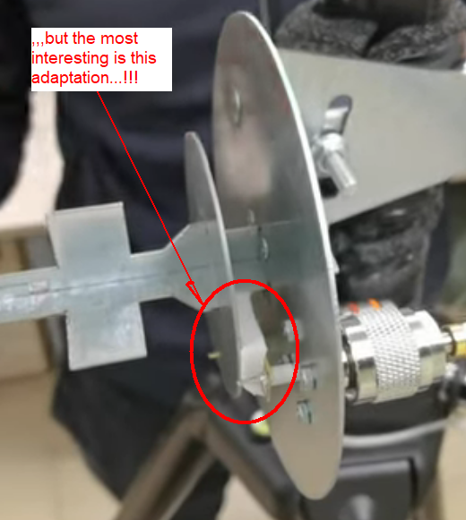

A little more bandwidth with the Proximity FEED TAB (instead of direct contact)But yagi bandwith is real limited...an NEW whole band Bow tie LPDA would have better bandwidth...
Proximity feed (quarter wave Lambda) Widens the bandwidth impedance...a little
I didn't like mine , if YOU want to tweak it , WORK over the feed tab size and distance to optimize the impedance bandwidth
,,,2.1---2.5 GHz, is the frequency range quite good...???
Directors EXACT size might matter and distances between them...Should look like this...kT4jSIS.jpeg
,,,400 mm length...for 2100MHz to 2600 MHz
