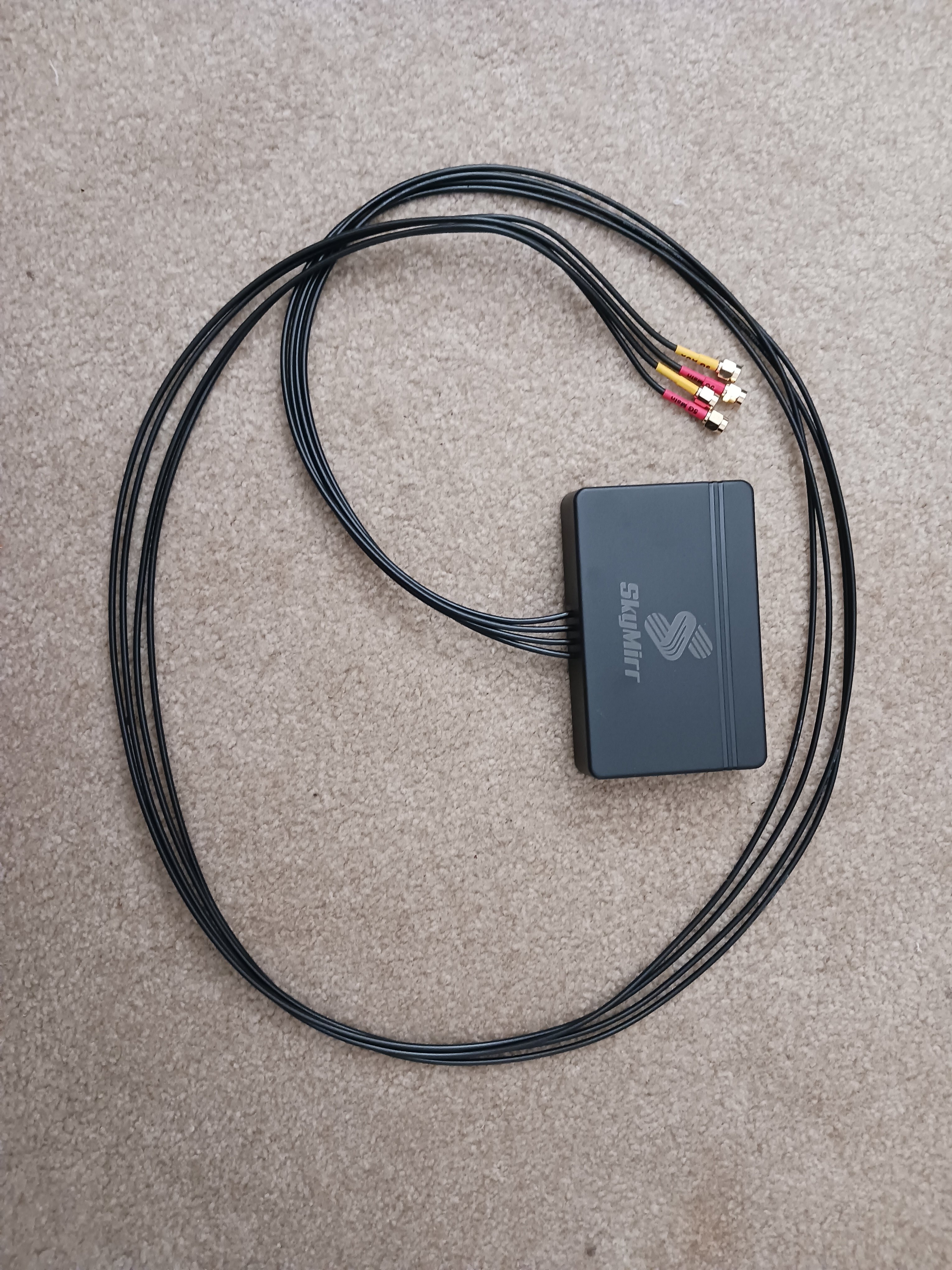

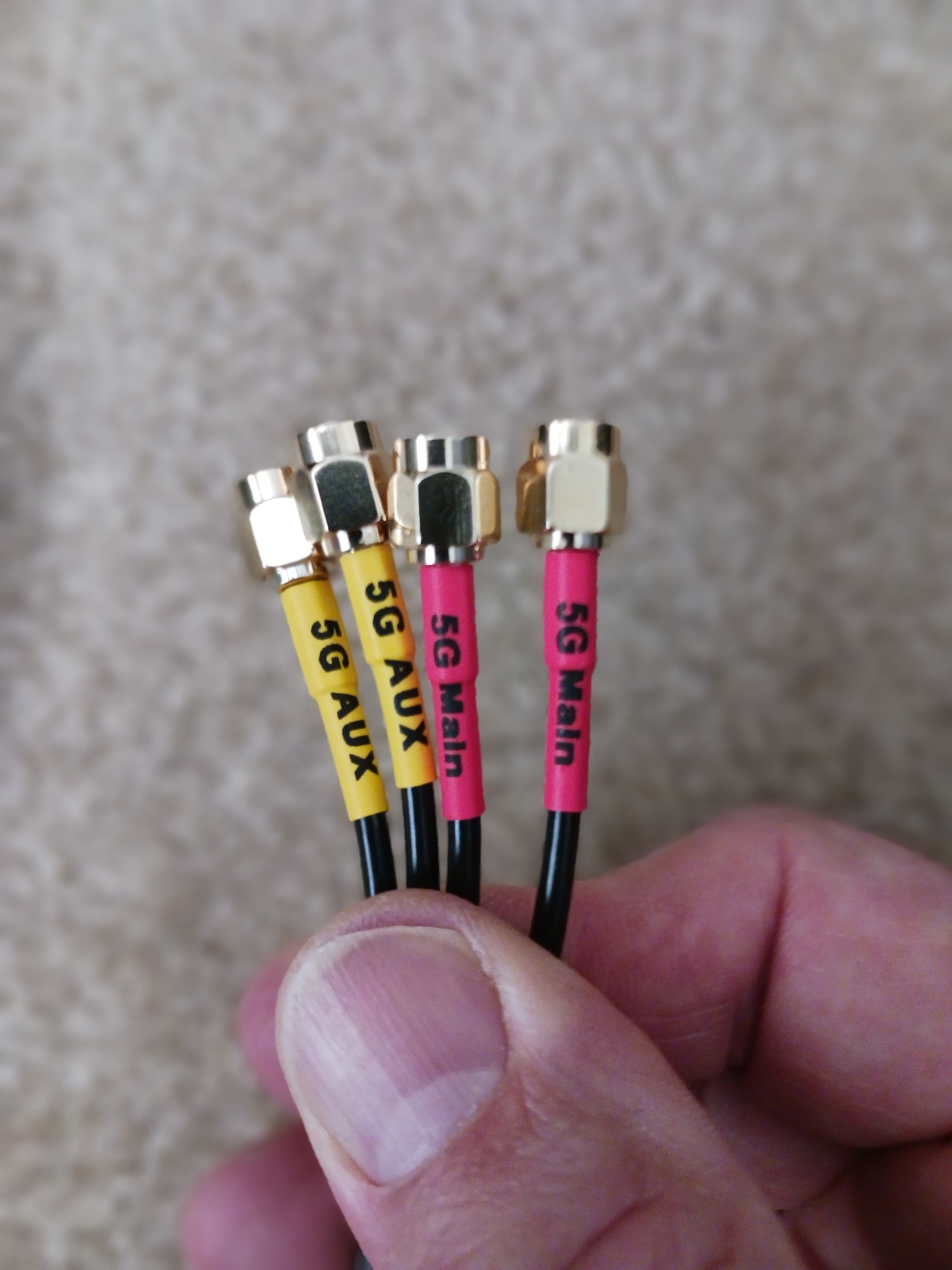

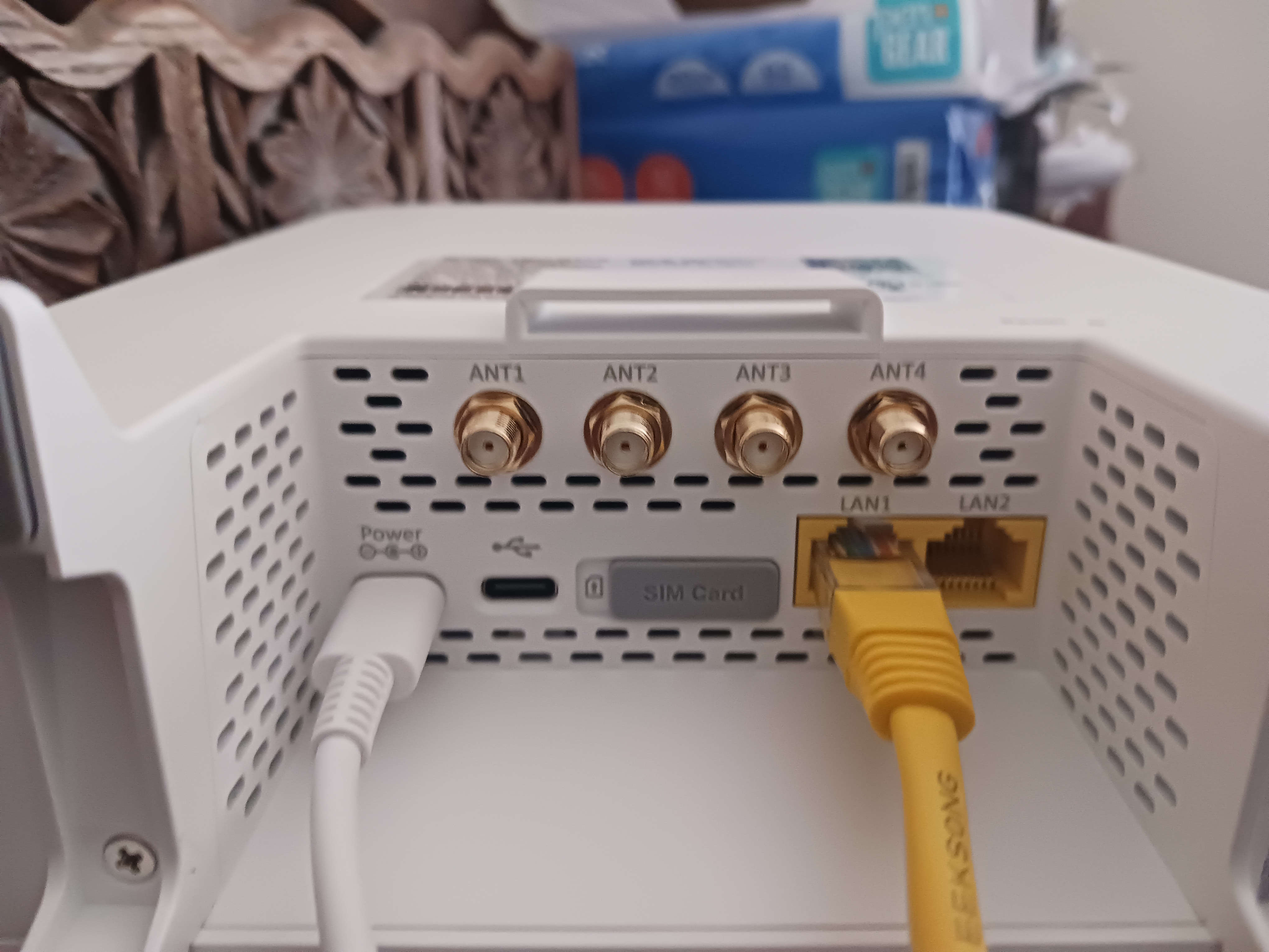

I purchased an exterior antenna to see if I could get better reception.  However, no support or instructions come with the antenna.  It has 4 connectors, 2 labeled 5G Main and the other two labeled 5G AUX.  The G4AR has four connection points for the exterior antennas labeled ANT1, ANT2, ANT3 and ANT4.  Anybody have any idea on which lead would go to which of the four possible ANT connections.

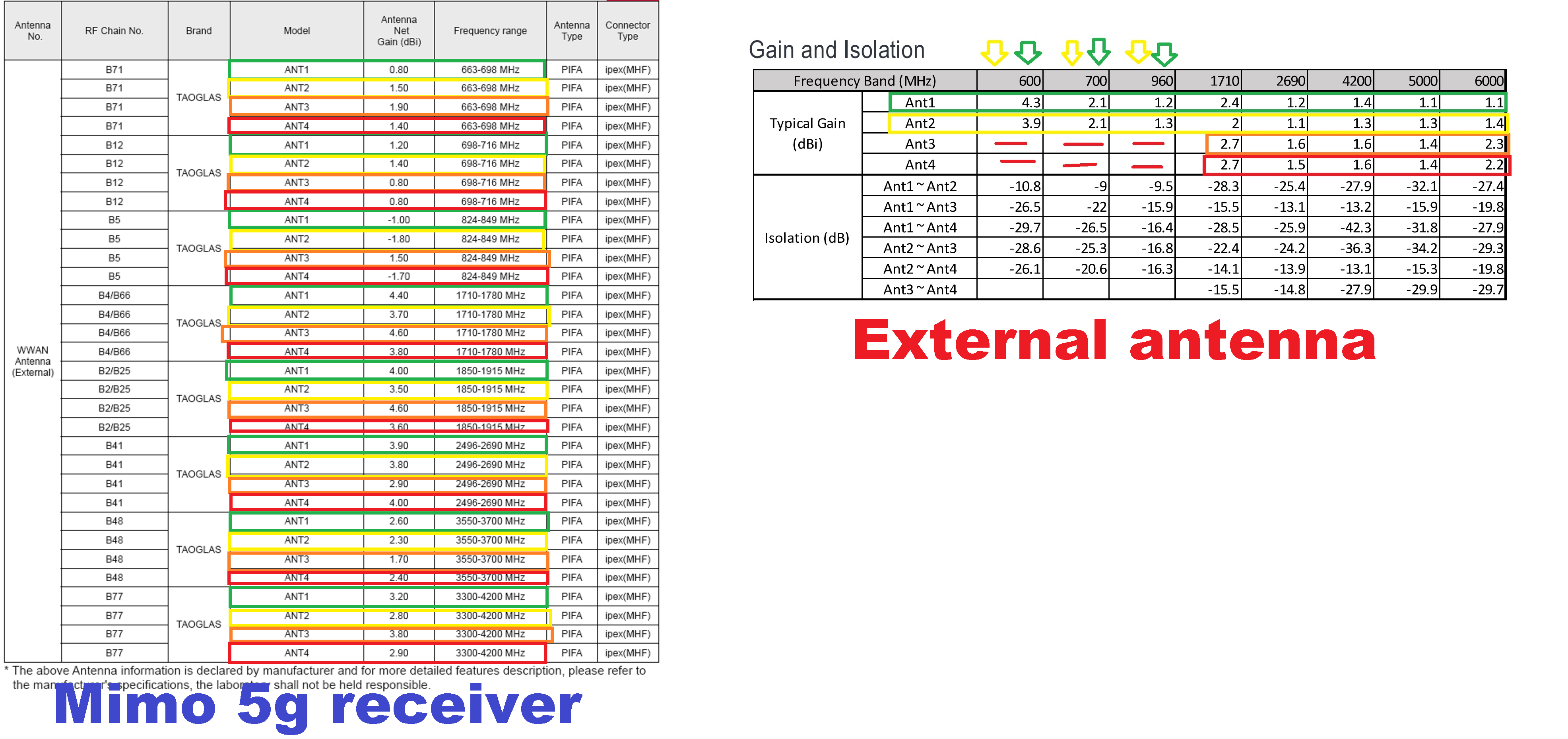

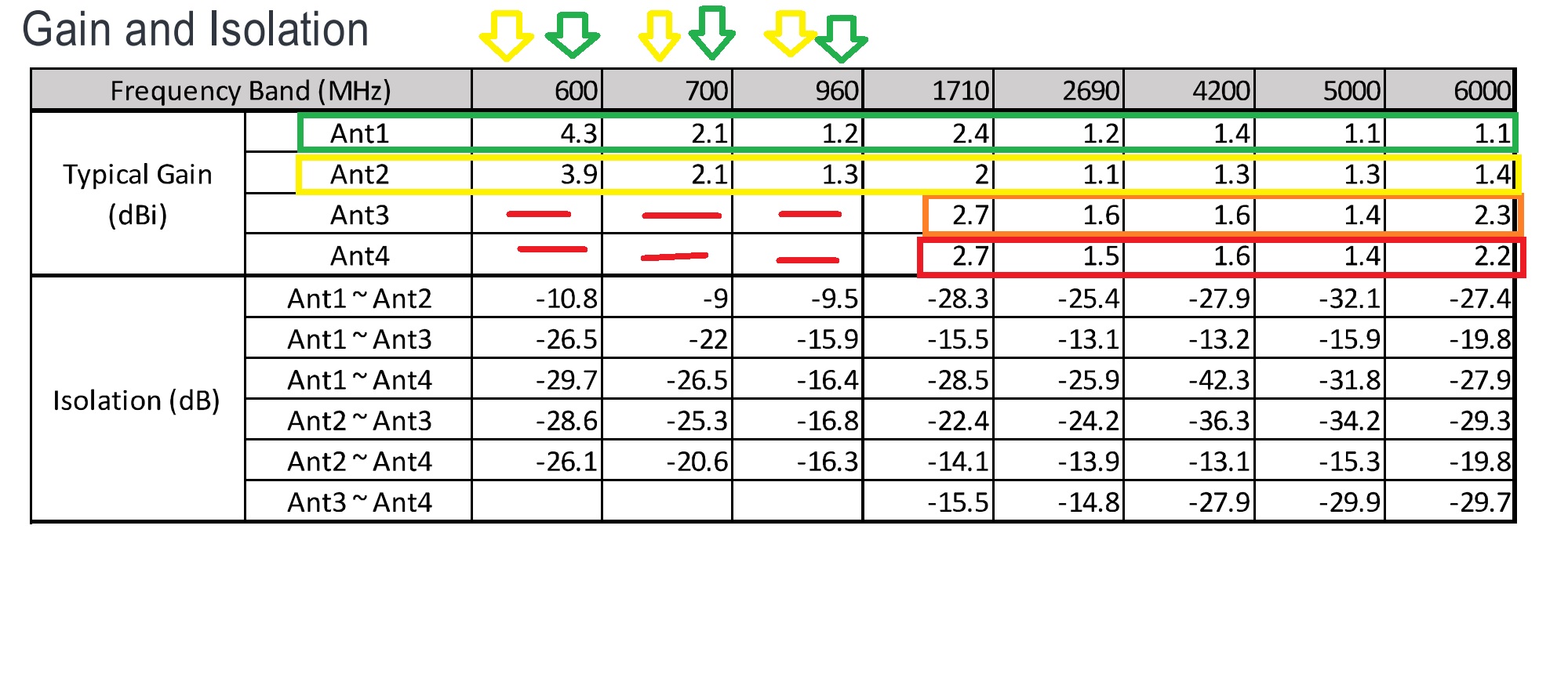

Ant 1 and 2 are for frequencies from 600 700 and 960 Mhz also
Ant3 and 4 are for frequencies ABOVE 1710Mhz
Check YOUR frequencies of interest
My G4AR indicates it is receiving a good 5G signal.  I just don't know which leads off the exterior antenna (5G Main or 5G AUX) to connect on ANT 1, ANT 2, ANT 3 or ANT 4?

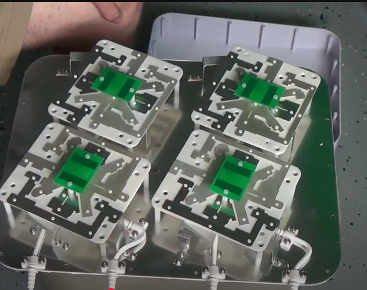

Clanon, the antenna could be one of these types.....???!!!!!
TAMP125 NO IDEA...but nestiam might open the box and SHOW US...

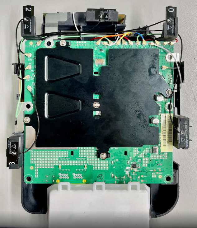

the receiver has a lot of netbook antennas inside (no good)
not sure manual CALL'em ANT1 ANT2 ANT3 ANT4
