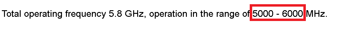

Additional features- Operating frequency range: 5000-6000 MHz.

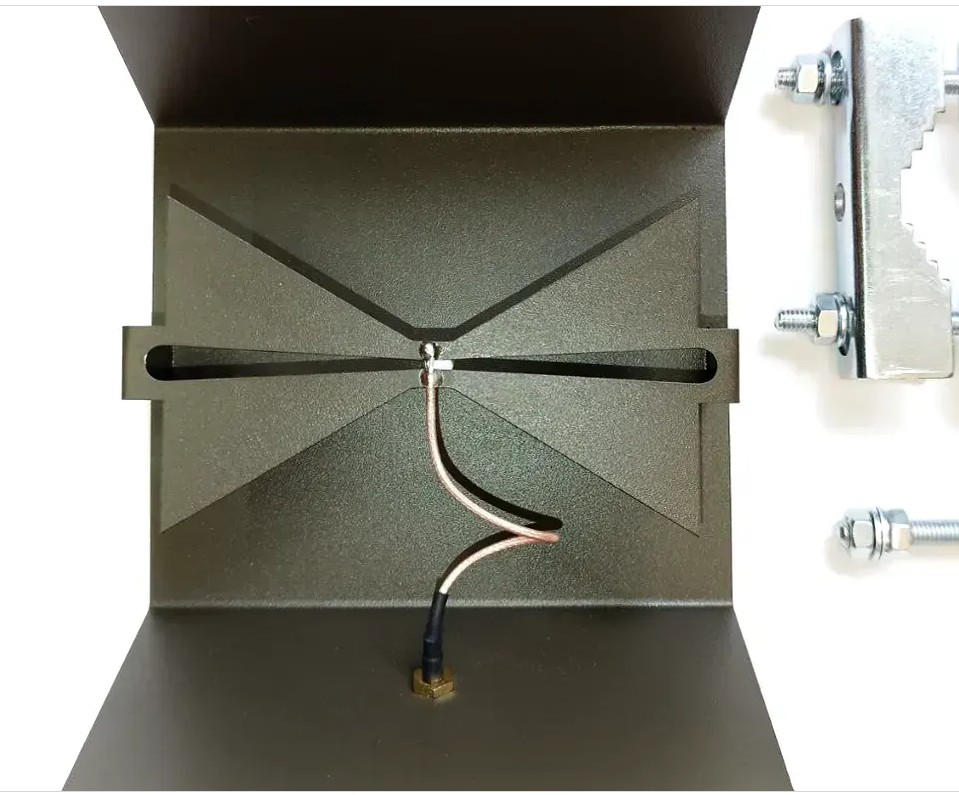

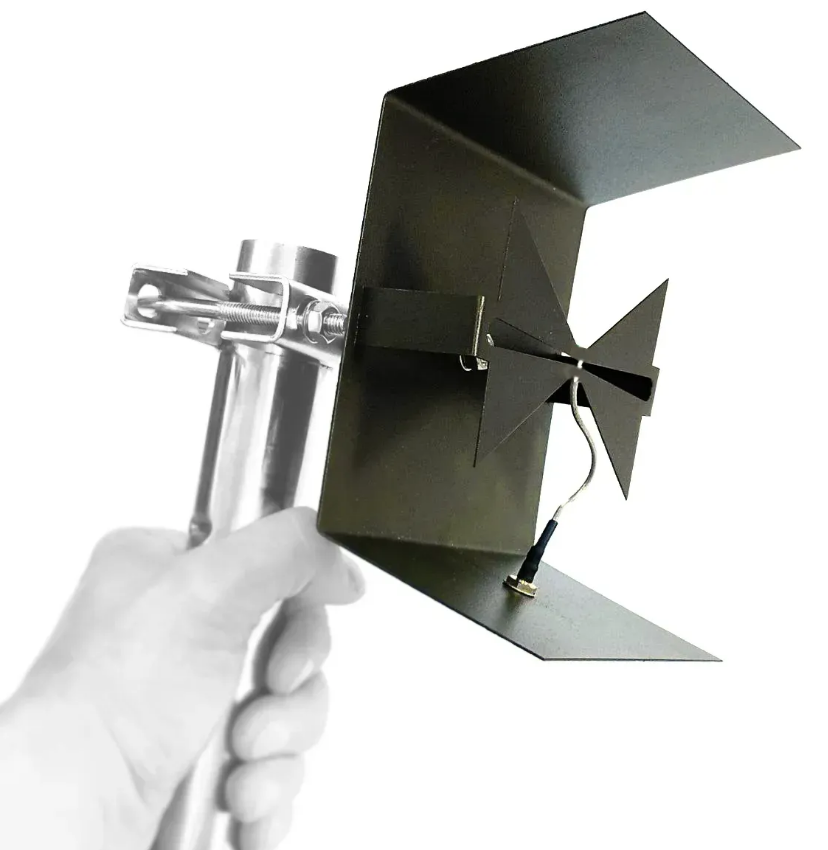

,,,and yet I don't understand why its dimensions are so large,150x130x65 mm , for the 5.8 GHz frequency,....????
OKAY, BUT THE DIMENSIONS SEEM TOO LARGE FOR THESE FREQUENCIES...!!!....150X130X65 mm
the materials maybe... Material: galvanized iron + powder enamel. (easy to copy and test...)
I tried to do a simulation for this antenna and it resulted in some miniature dimensions....!!!
,,,and for the 5.8 GHz frequency...
Dimensions are related to Lambda , it might be Full wave to work...like a Quad...
did you try an Array...?
