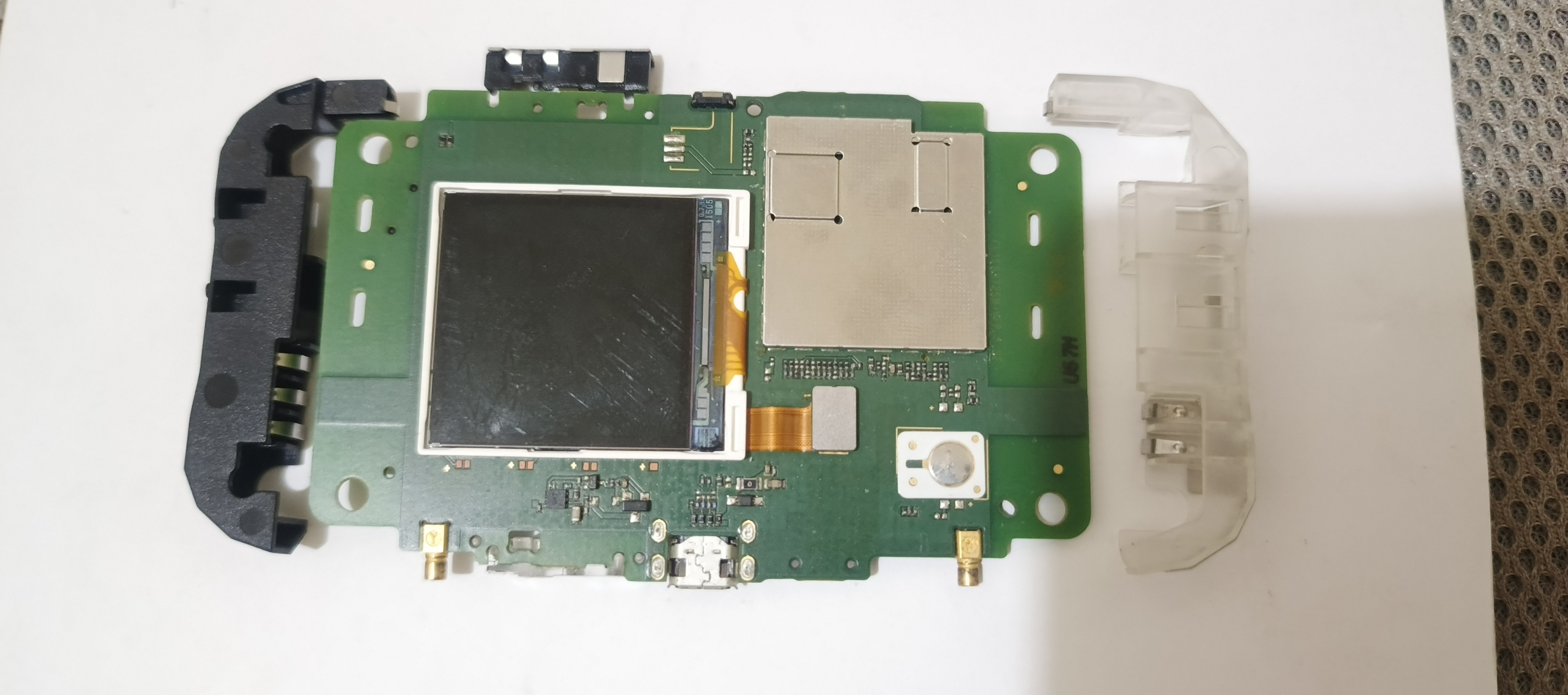

i have huawei E5372s, image below
im wondering where to solder antenna for the 4g connection as there is many option.
4G 1800-2400
,,,as you can see, the modem has two plugs for connecting antennas...!!!

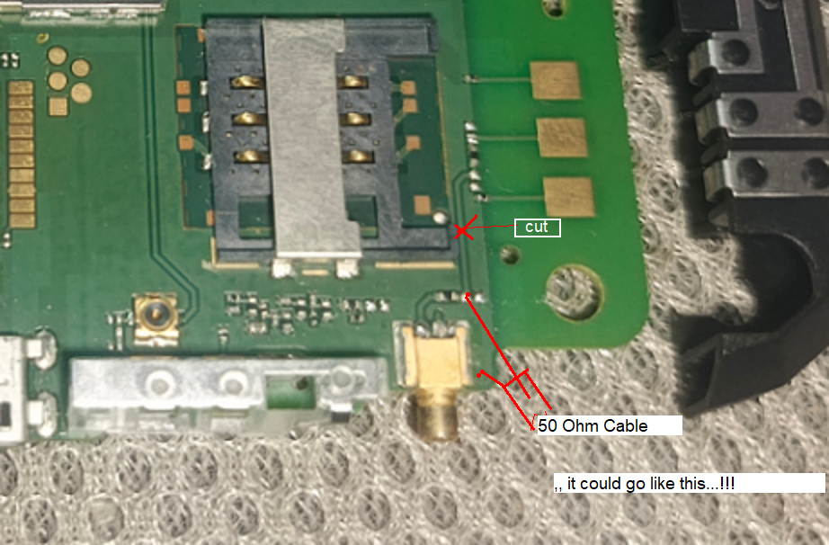

so it does not matter where i solder the wire on one of the two ? is it both 4g path?
,,,why solder a wire, that's where the antennas are connected...!!!
i dont have ts9 connector its hard to find ts9 connector so i might as well solder the cable
