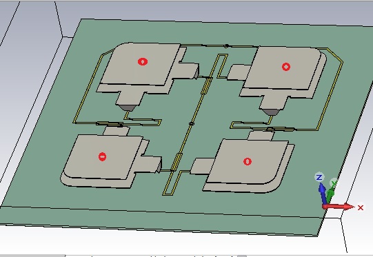

I think this would be a better solution...

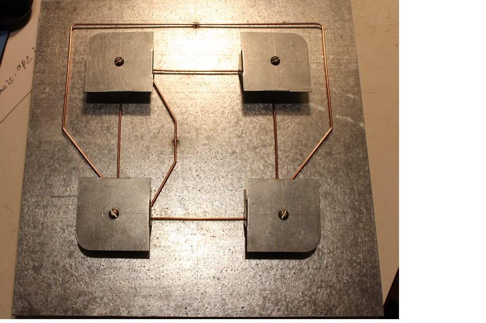

Крепление F6 Cu ?
Патч 0.5 мм ?
RF4 1.5 мм или 2.0 мм?

"No, but I'm going to try to make such an antenna on PCB...

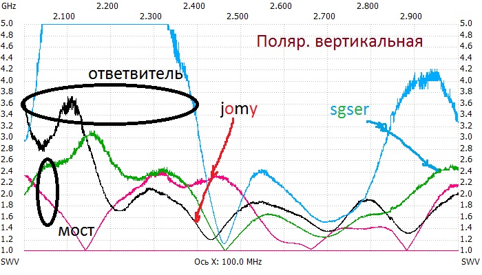

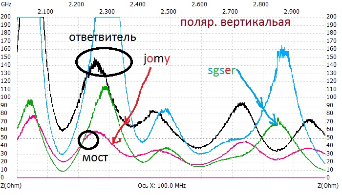

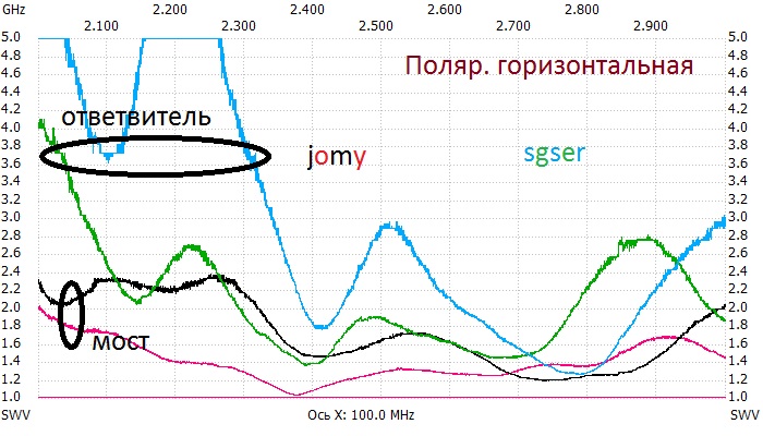

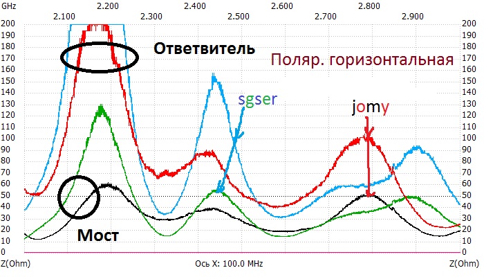

Результаты измерения на моем NWT.
Мост и ответвитель самодельные.
Антенны sgser и jomy
The measurement results on my NWT.
The bridge and the coupler are self-made.
Antennas sgser and jomy
ответвители >couplers
мост>bridge

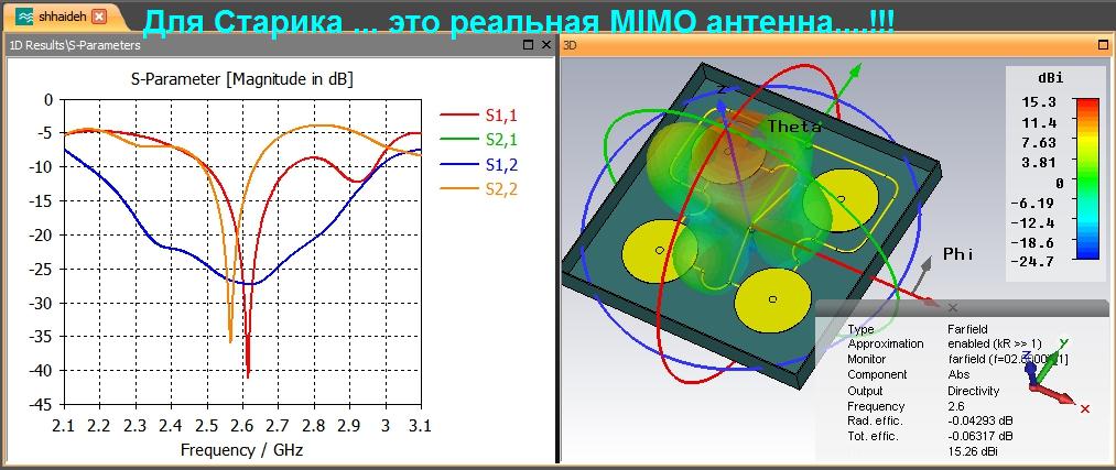

", some of Starik's achievements...!!!
