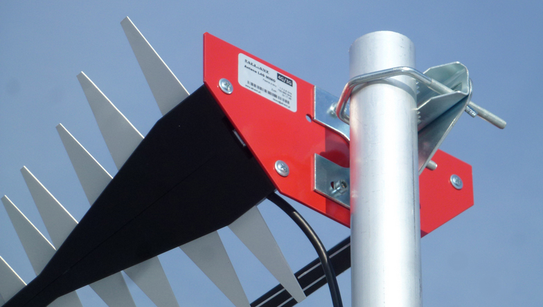

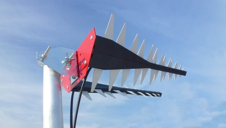

HIGH QUALITY Antenna LTE L4G DESPITE 2x15 dBi of 1.7-2.6 GHz SMA 2x10m
L4G DESPITE / 15 dBi - team of two multi-band antennas for data transmission over the cellular network.
L4G DESPITE the fact intended for operation of different channels of transmission and reception.
Works in all existing and future networks in Poland and Europe.
Operating frequency ranges: 800, 900, 1800, 2100 2300, 2600 MHz.
Supported technologies:
• 4G LTE MIMO Dual Carrier HSPA + Dual Carrier
• 4G, DESPITE the 2300MHz and 2600MHz
• 3G, 2G
• Also supports wi-fi Wireless 2400MHz on two antennas.
Application:
• All modems and routers, 4G LTE, HSPA +, WCDMA, UMTS, HSPA, 3G, 2G/GSM
• Allows you to build a reliable connection service high speed broadband Internet access.
• Required for areas with a weak to medium signal level, and in urban environments with dense buildings..
This simplifies the installation of the antenna, even people who do not know technical problems.

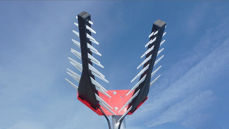

Nothing new . Logarithmic antennas.
But I do not understand why they are put in slant polarization mode.
This way, every  polarization  lost 3 dB.
15 dBi ..!!????
Good, you are right, but you know how the logarithmic dipoles are synphased...!!!???
It is a system of two directional antennas, external, on the contrary, polarized, designed for data transmission in cellular networks in the DC (Dual Carrier). Two antennas installed on the system, X-pol, and provide excellent separation between the channels of the MIMO transmission. Team reduces thereby the number of errors in the signal, and raised to a higher level of data transfer rate. Perfectly solves the problem when the signal is too weak for proper operation of the modem or repetera. Modern design, log-per construction, provides a high income with a very wide range of moves frequency.
