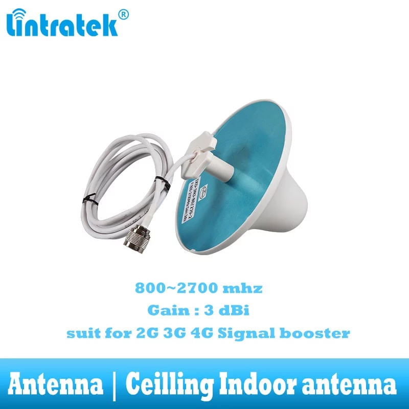

Lintratek 2g 3g 4g indoor antenna 800~ 2700mhz
* Communicate with GSM 850 900 1800 1900 2100 2600 signal repeater
* Indoor ceiling Installation
* Frequency range: 800 ~ 2700mhz Internal antenna
* Operating system: 2G 3g 4G LTE CDMA GSM DCS WCDMA network signal LTE2600
* High quality (1 year warranty)
* Antenna gain: 3dBi
* Connector: N male
* Cable length: 2 meters

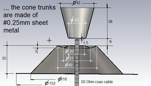

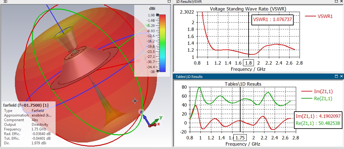

It's broad band ant but preferably for urban area where the tower is close. Also it's not for DIYER

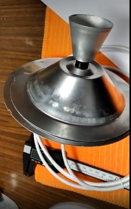

However, I don't think it's that hard to build...

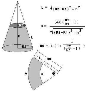

,,, calculation formulas...
