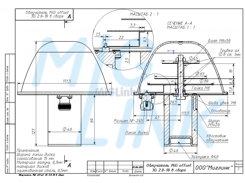

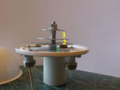

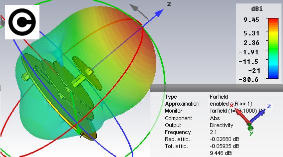

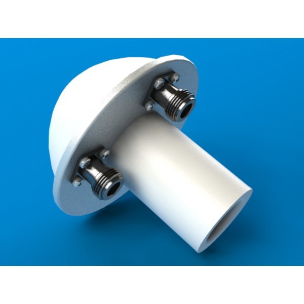

3G feed MiG Offset LTE MIMO 2.1-10 for offset plates are designed for use in conjunction with offset dish satellite antenna. The irradiator is installed in a regular place of attachment of the satellite Converter and gives a powerful gain of up to 28dBi. If Your 4G modem works bad in the country, and low-speed Internet access and a small signal level is not satisfied, then installing 3G LTE 2100 radiator on a plate from a satellite antenna You get reliable reception of the 3G signal at a considerable distance from the base station.

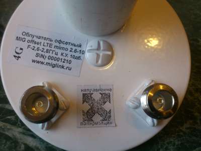

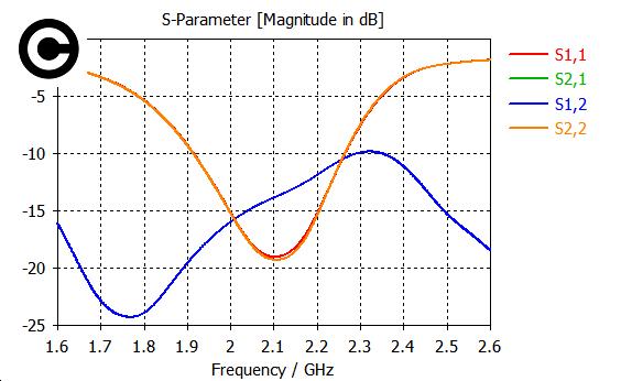

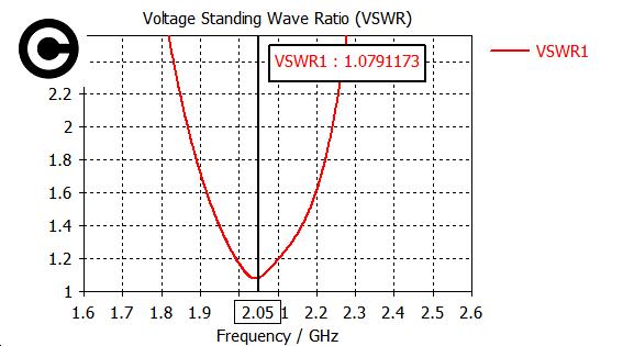

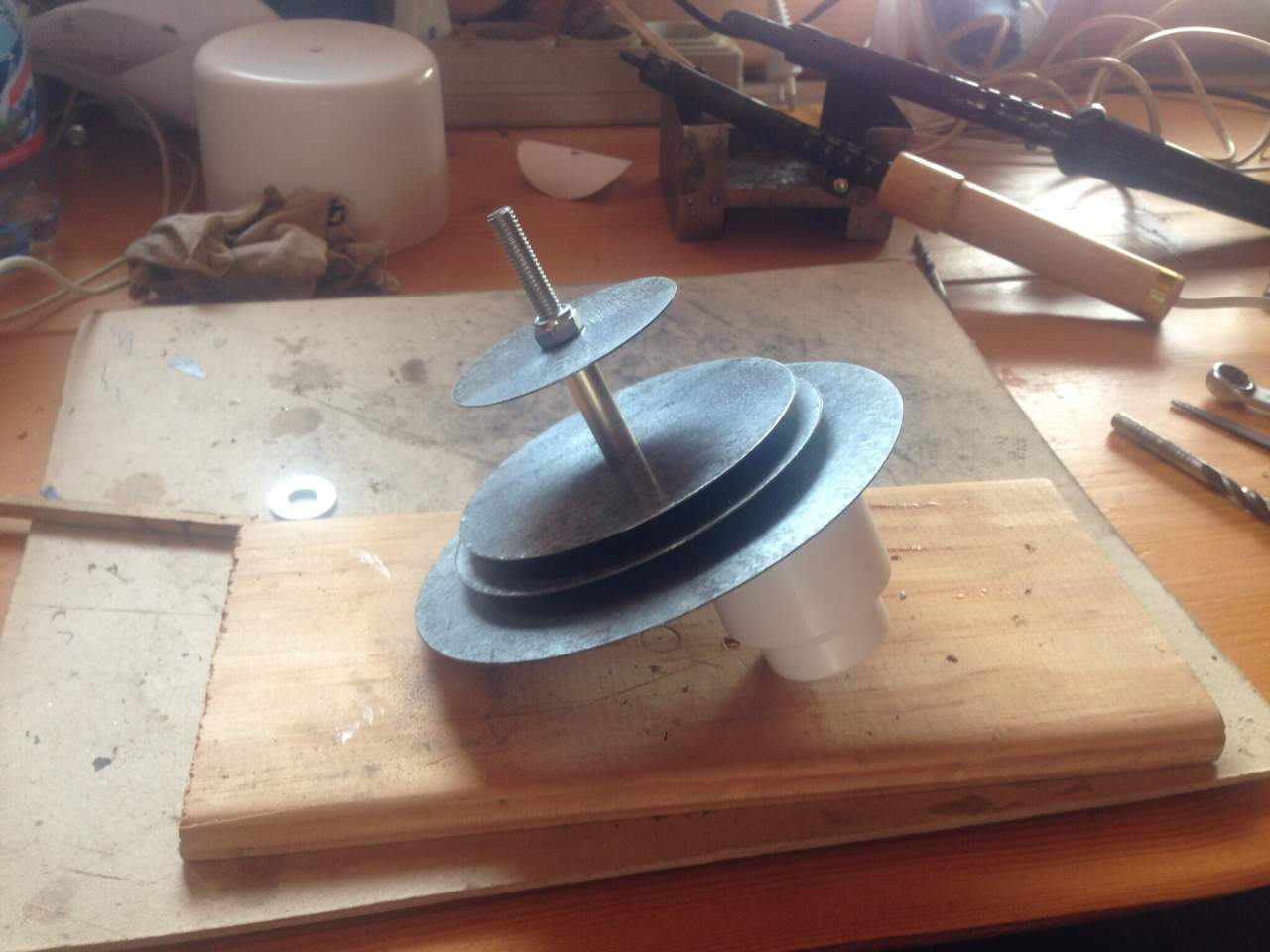

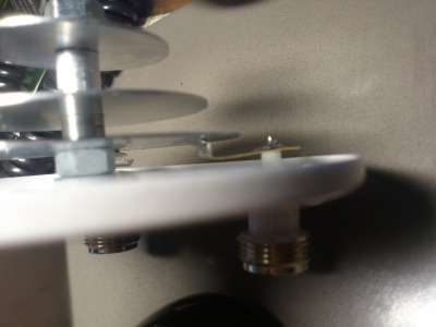

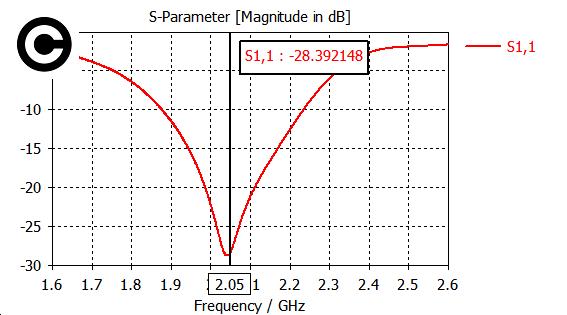

"and the MiMo version...
,,,user Kledi sais,,,"Can i have a non-mimo version of this for lte2600? With 1mm steel thikness"
I say yes, but with other dimensions...!!!
,,, this is easier to do...
,,, Kledi, try not to post my images in duplicate...!!!
,,, just say what you have to say..!!!

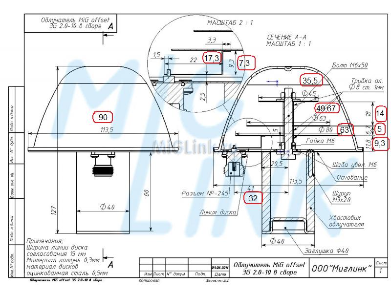

Can we have the lte1800 dimensions?

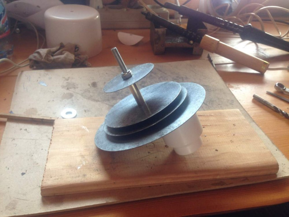

Im Building the 2nd dish :)
On 6/18/2020 at 6:43 PM, Kledi said:
Thanks,
-quotes in blue = 1800MHz
-quotes in red = 2400MHz
На 1800 ? Указан размер между 2100 и 2400 ? Пересчитать ?
At 1800? Is the size between 2100 and 2400? Recalculate?
