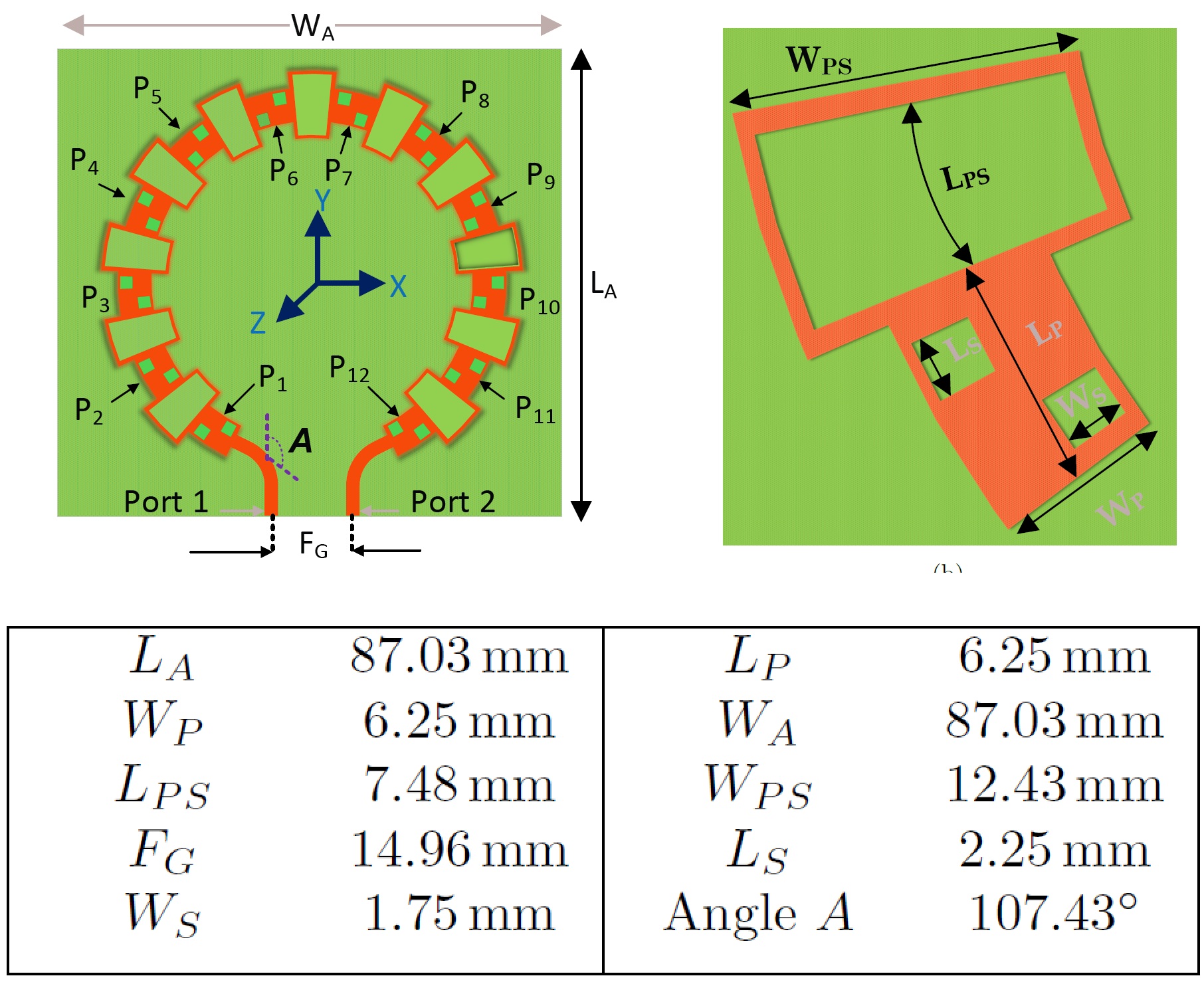

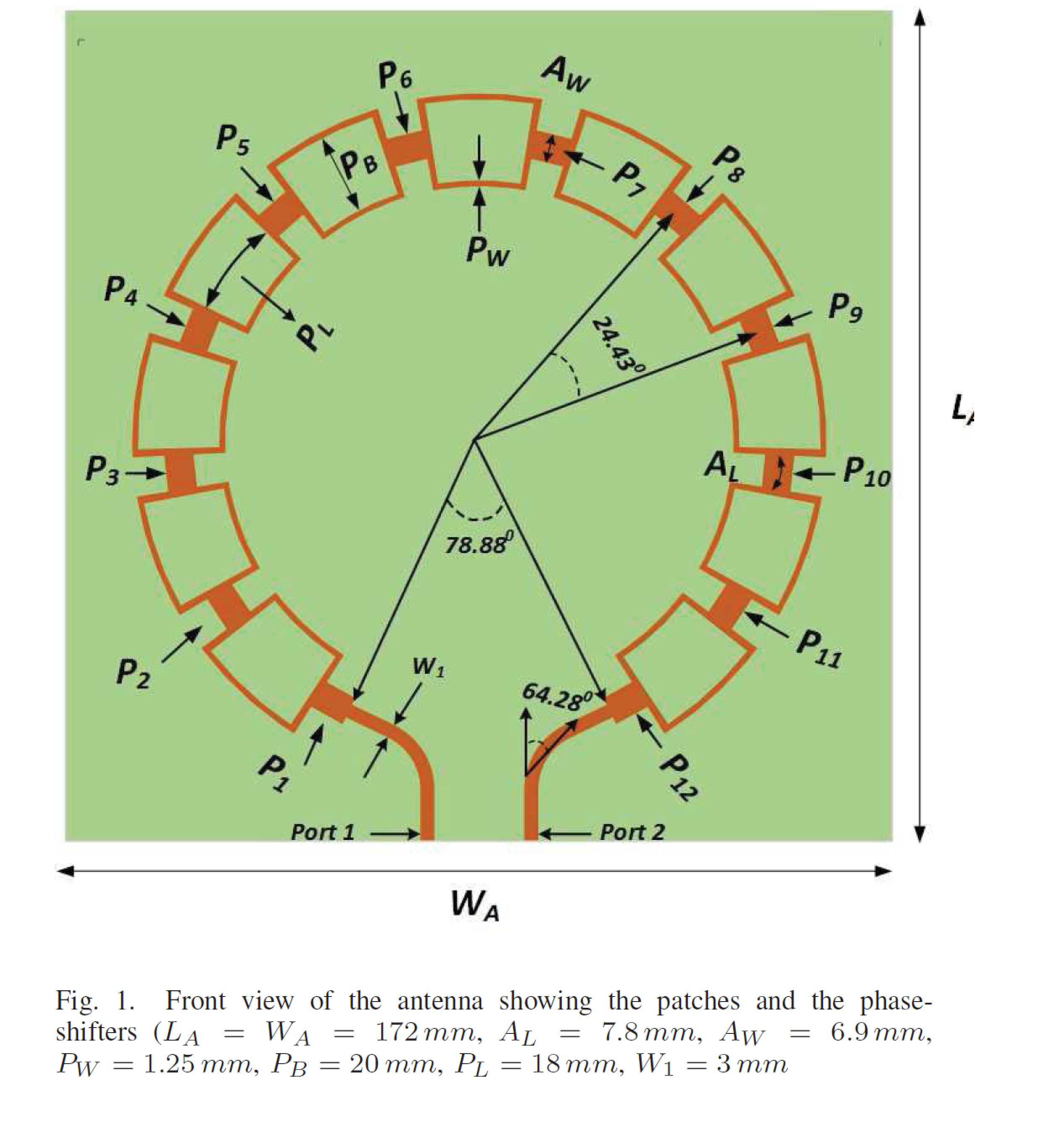

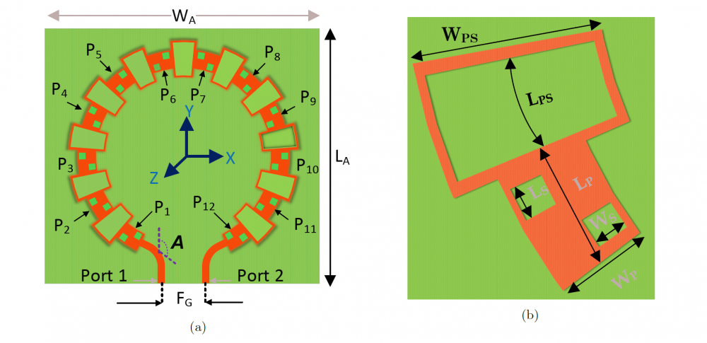

High gain ...? dual linearly polarized
,,,, but the dimensions are for the centre frequency f0 = 7.74 GHz...!!!!
,,,for 2,442GHz LA=WA=275mm or 545mm....so the antenna will be very large...!!!!
maybe it will be worth to adapt it at 5.8GHZ...?
,,,okay,for 5,8GHz LA=WA=116mm or 230mm....I think that would be almost reasonable...!!!
