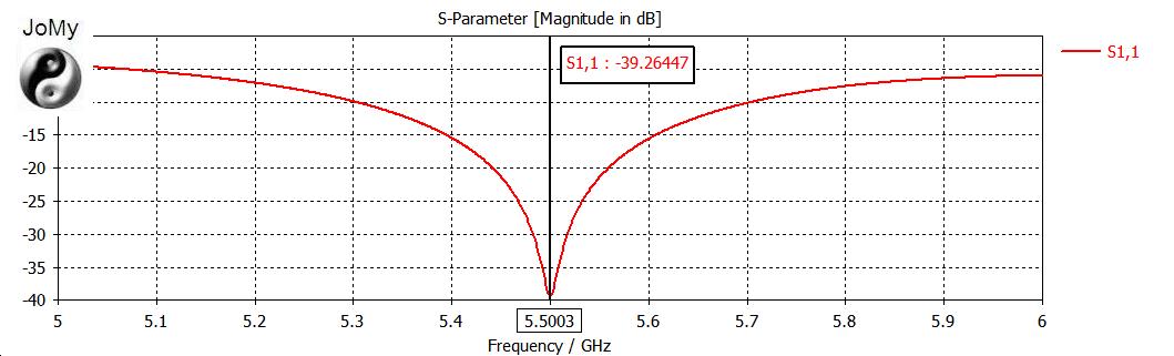

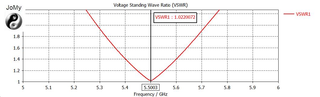

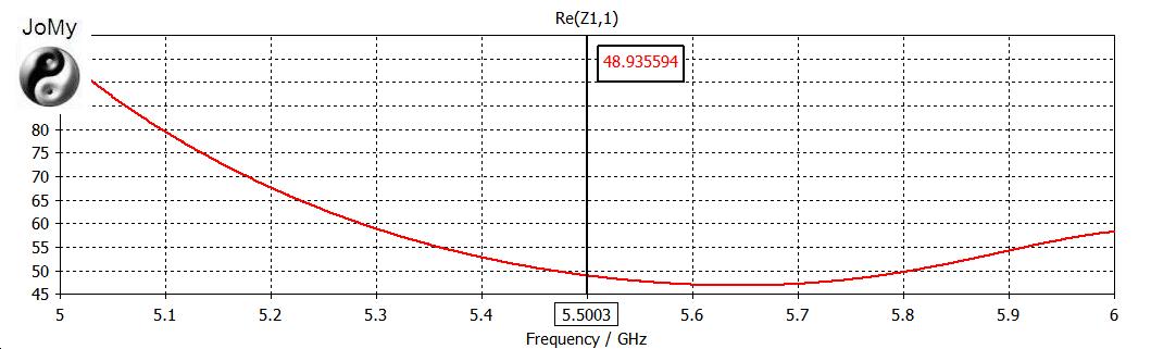

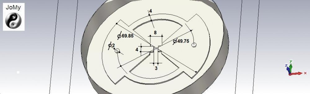

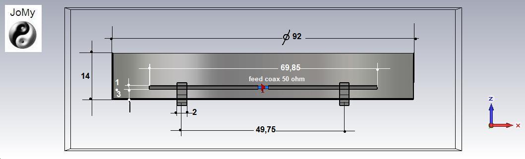

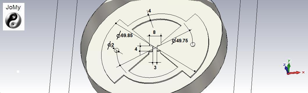

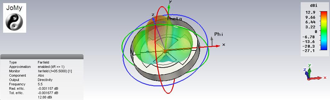

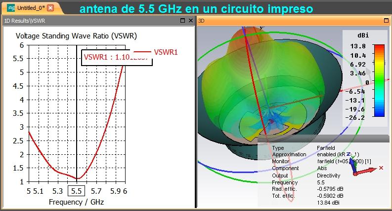

,,, of course my friend, but I will try to do a simulation in this sense....!!!!
,,, you want to be conical or without a cone....???
For the production of conical-will be hard for home-made. better - without conical
