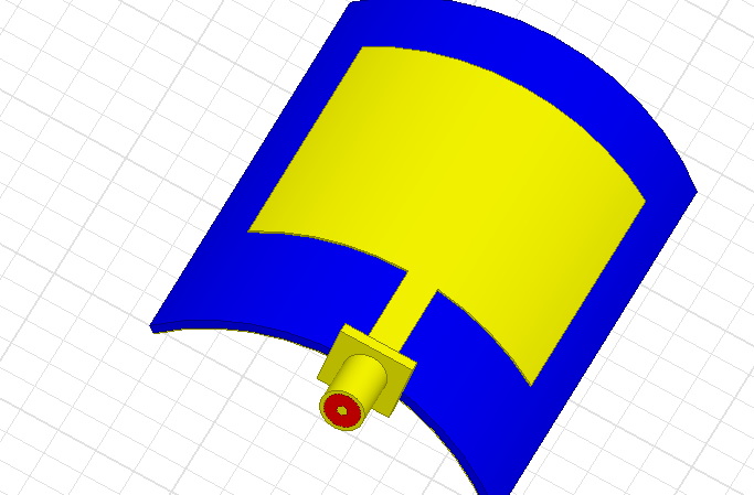

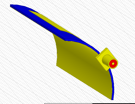

Hi friends, conformal antennas gaining a lot of attention from the researchers across the world nowadays. i will explain you the necessary steps required to design a conform antenna in hfss.

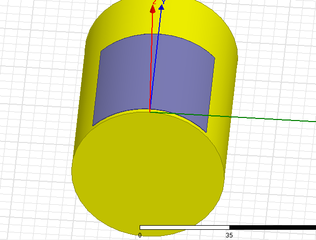

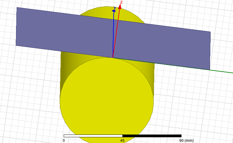

Step1: First create a 2D rectangular sheet in HFSS with ranom dimensions
step2. Create a cylinder with radius 30mm
step3: Now select the two objects and perform the following commands-> right click->EDIT->surface->wrap shet. then assign thickness to the sheet
