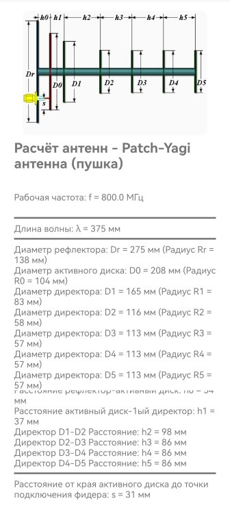

Hello everyone. Need your help. I need a small and simple LTE antenna for Band 20 (800 mhz) to receive a signal from another tower from a mobile operator in my region. Interested in the model from the "Cantennator" program. Only here its dimensions in the program seemed strange. If possible, then simulate such an antenna for Band 20. Thank you in advance for your help.

I agree with you that the "Contennator" program is not very accurate.
Thank you for telling me where I can find the models I'm interested in.
I would greatly appreciate your assistance in developing an antenna model for Band 20.
