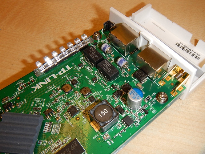

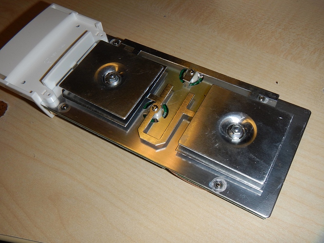

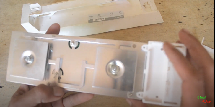

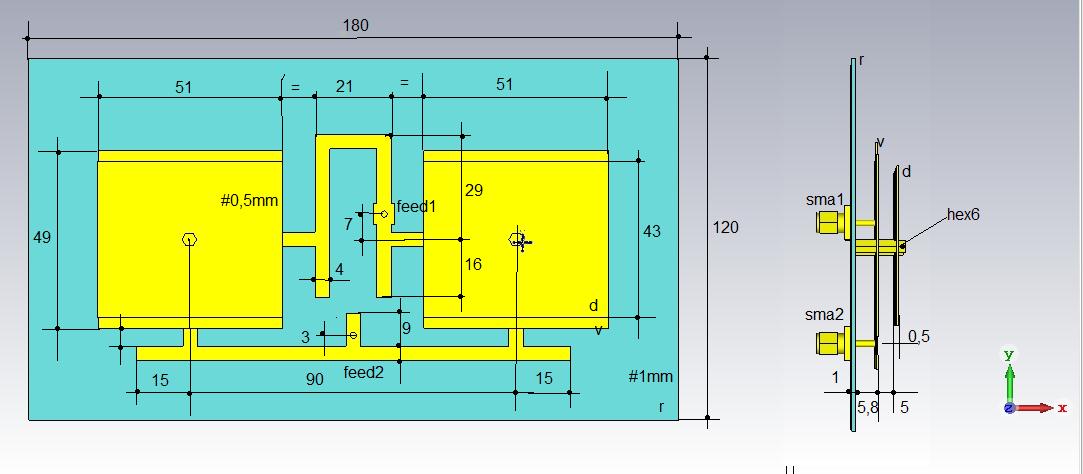

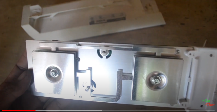

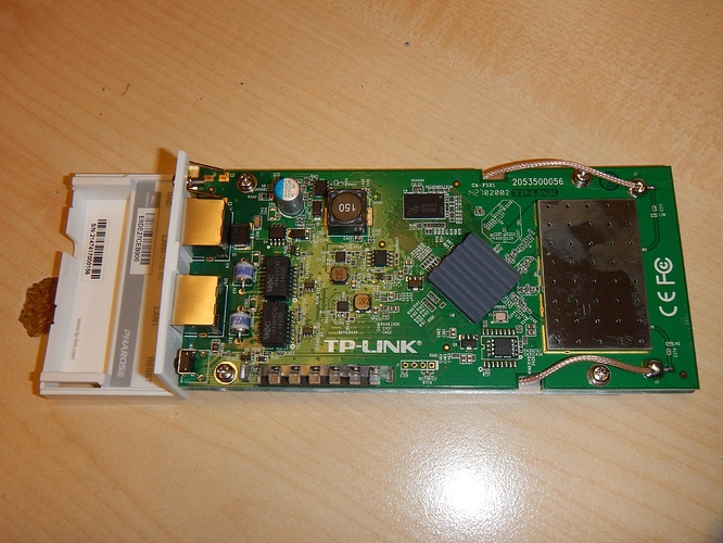

TP-Link CPE210/220 is a 2.4Ghz outdoor access point similar to Ubiquiti NanoStations. There is also a 5GHz Version of this AP, the TP-Link CPE510/520. The device has a built-in 12dBi 2x2 dual-polarized directional MIMO antenna with a beamwidth of 65° (H-Plane) and 35° (E-Plane)
 can i get the dimensions of this antenna cpe 220 thanks a lot.
