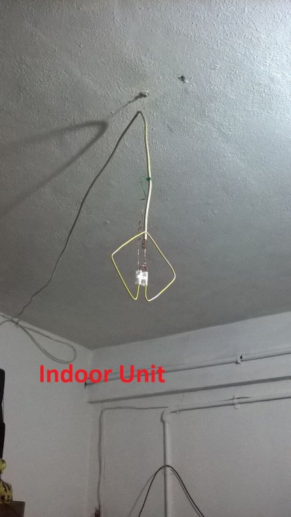

DIY 2G/3G/4G WIRELESS CELL PHONE SIGNAL BOOSTER

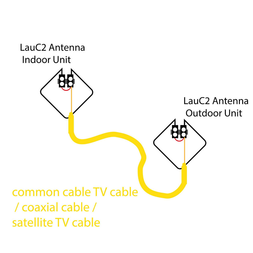

Looks quite simple. I suppose it will work if phone is placed very close to indoor unit.
Have you tried it? Upload some before/after photos with mobile phone's signal level bars :)

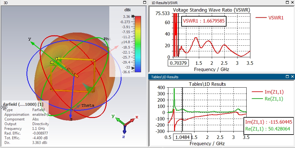

No, I did not try this experiment, but I could do a simulation...!!!

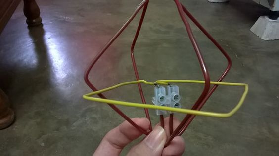

,,, a constructive variant for  cross polarization...
2G/3G/4G WIRELESS CELL PHONE SIGNAL BOOSTER,,,, after a simple simulation,....!!!
