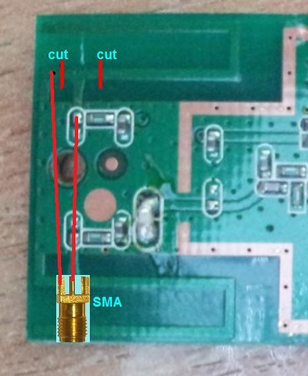

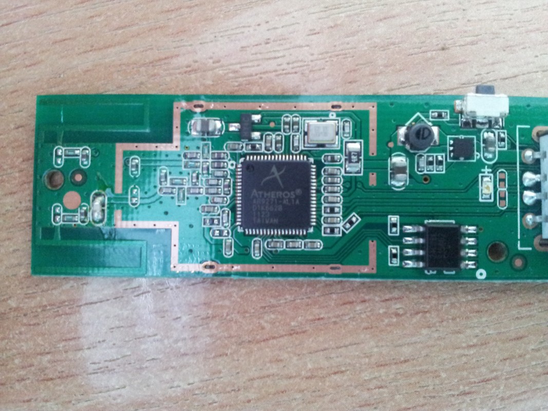

Please some one elaborate on this topic... actually i was trying to attach external antenna but when i checked with Multimeter the point showing in the diagram to connect sma is ground ( negative) the sma legs should be soldered with ground but where should i can attach the main antenna line..please help me .The device showing in this diagram is same with mine.Thank you
Thank you Soo much.I will try and update Signal gain after this modding.
