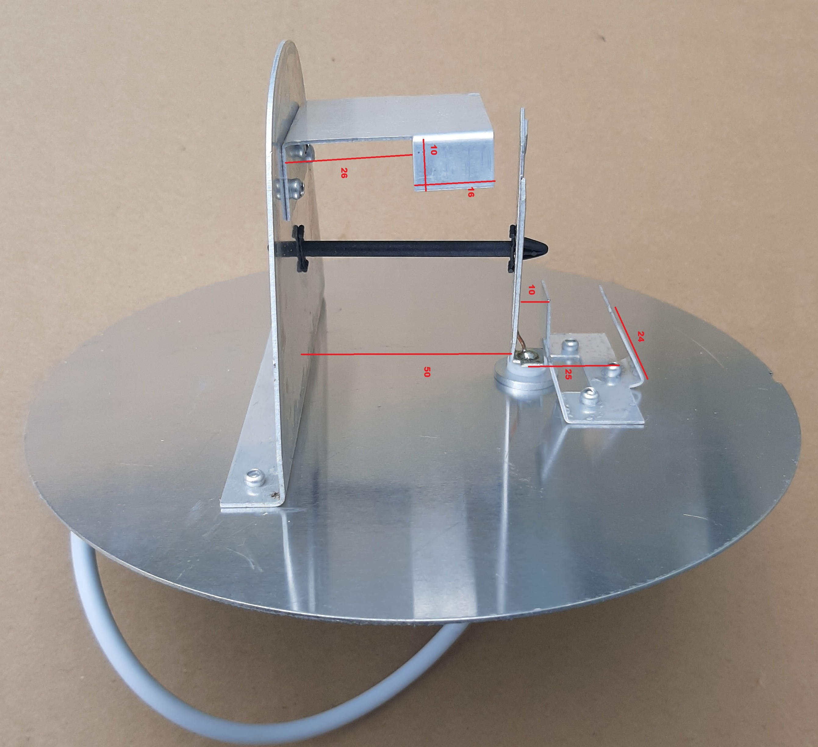

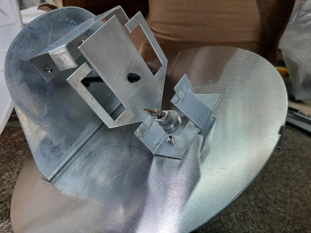

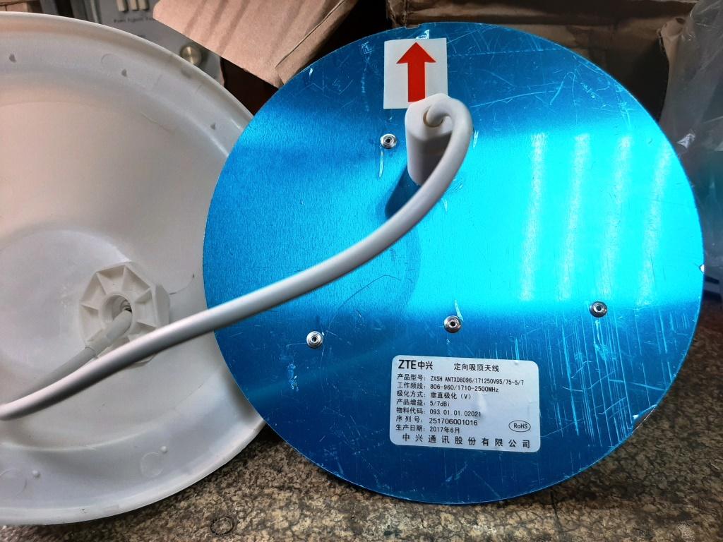

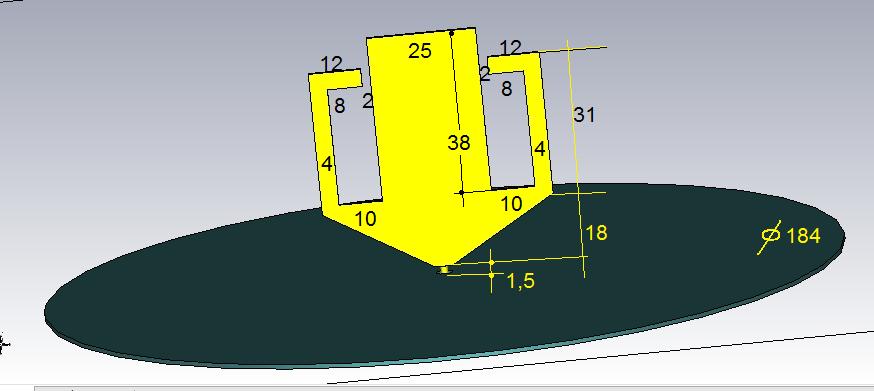

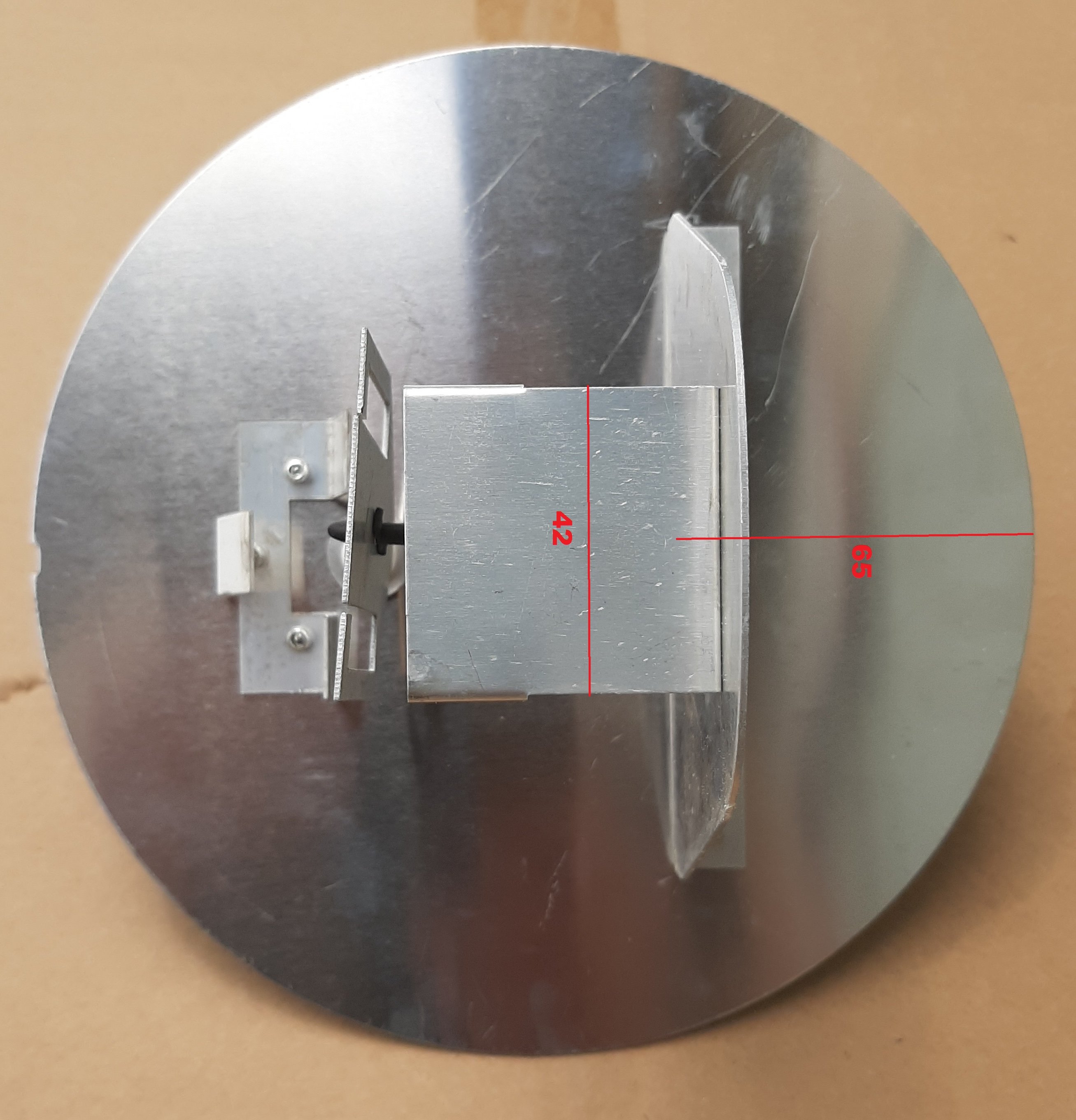

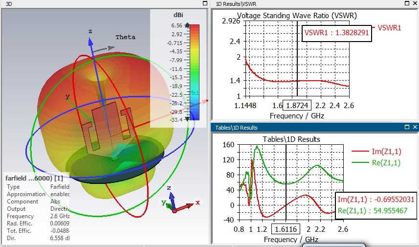

I tried to simulate this monopoly antenna and it seems to provide a fairly wide bandwidth..

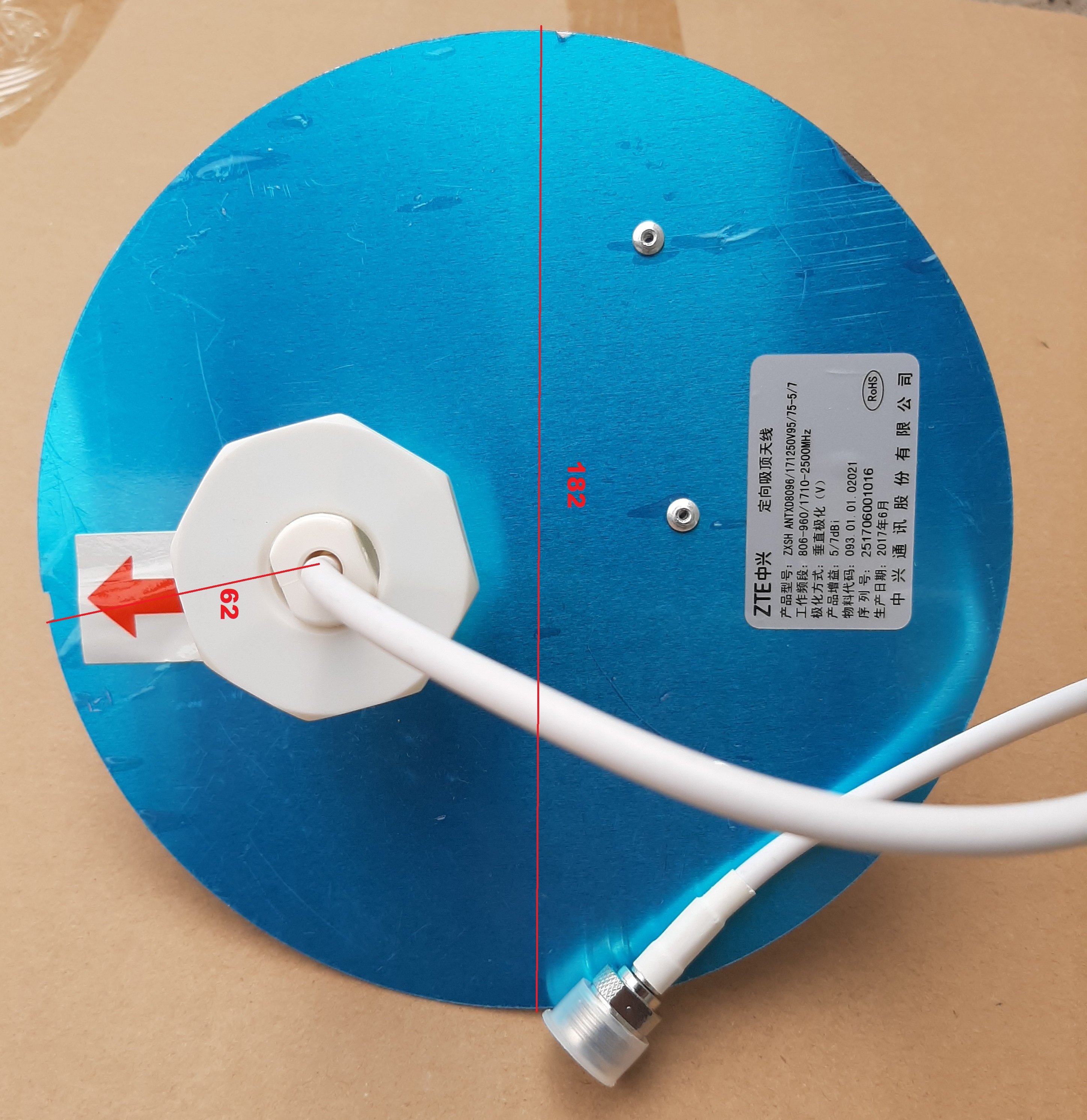

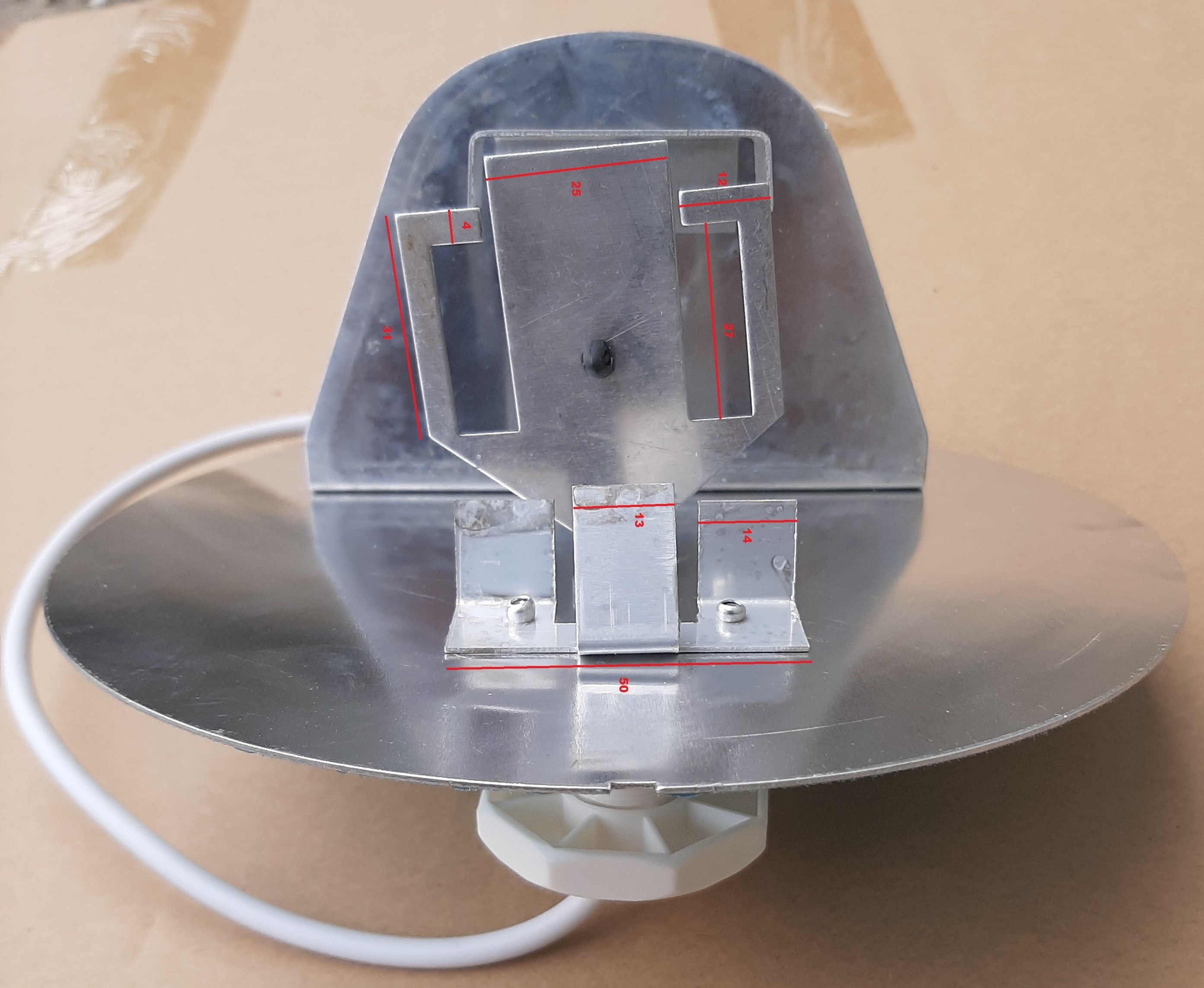

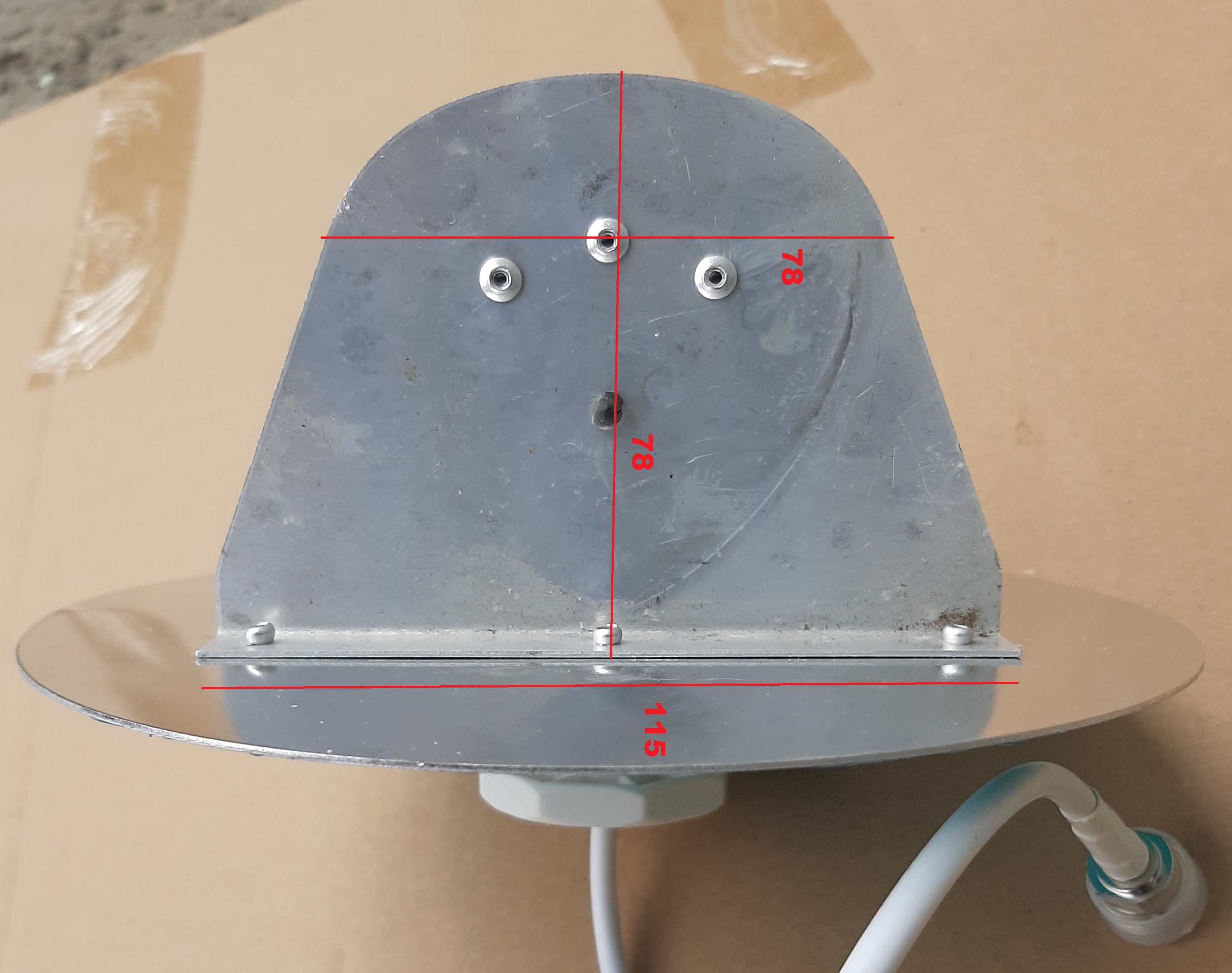

Thanks the user "com666" for transmitting the dimensions of this antenna...

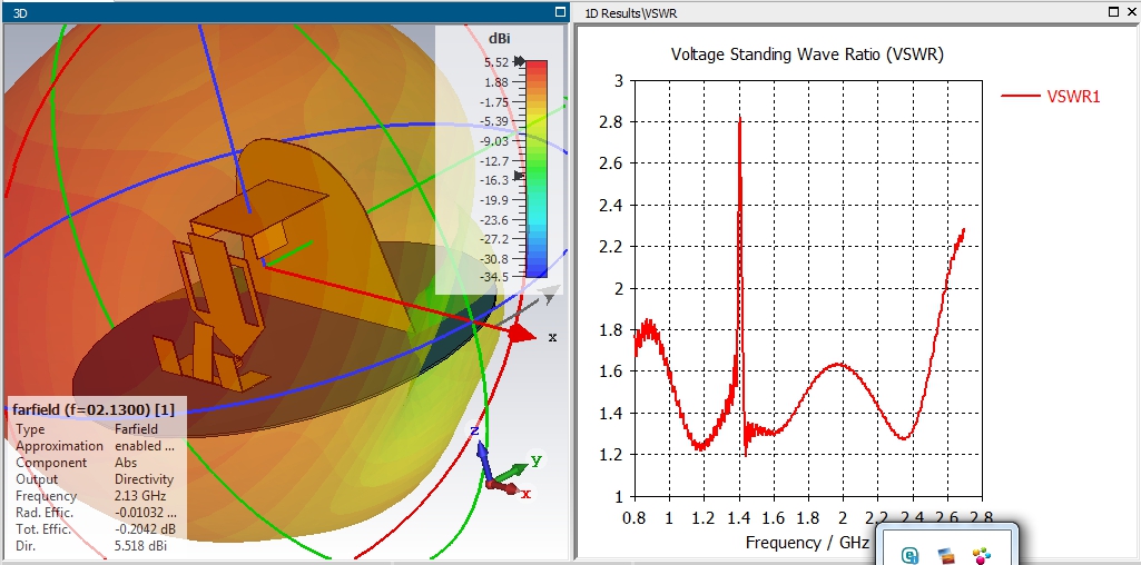

,,,, and these are the results of the simulation but I think that the position of the vibrator must be modified to obtain the maximum operation...
its same dimension with com666 picture?
24 minutes ago, Admin said:
,,,I think not...!!!
can u post the detail sir? im intersted because the wideband response
,,, that's about it ... !!!
