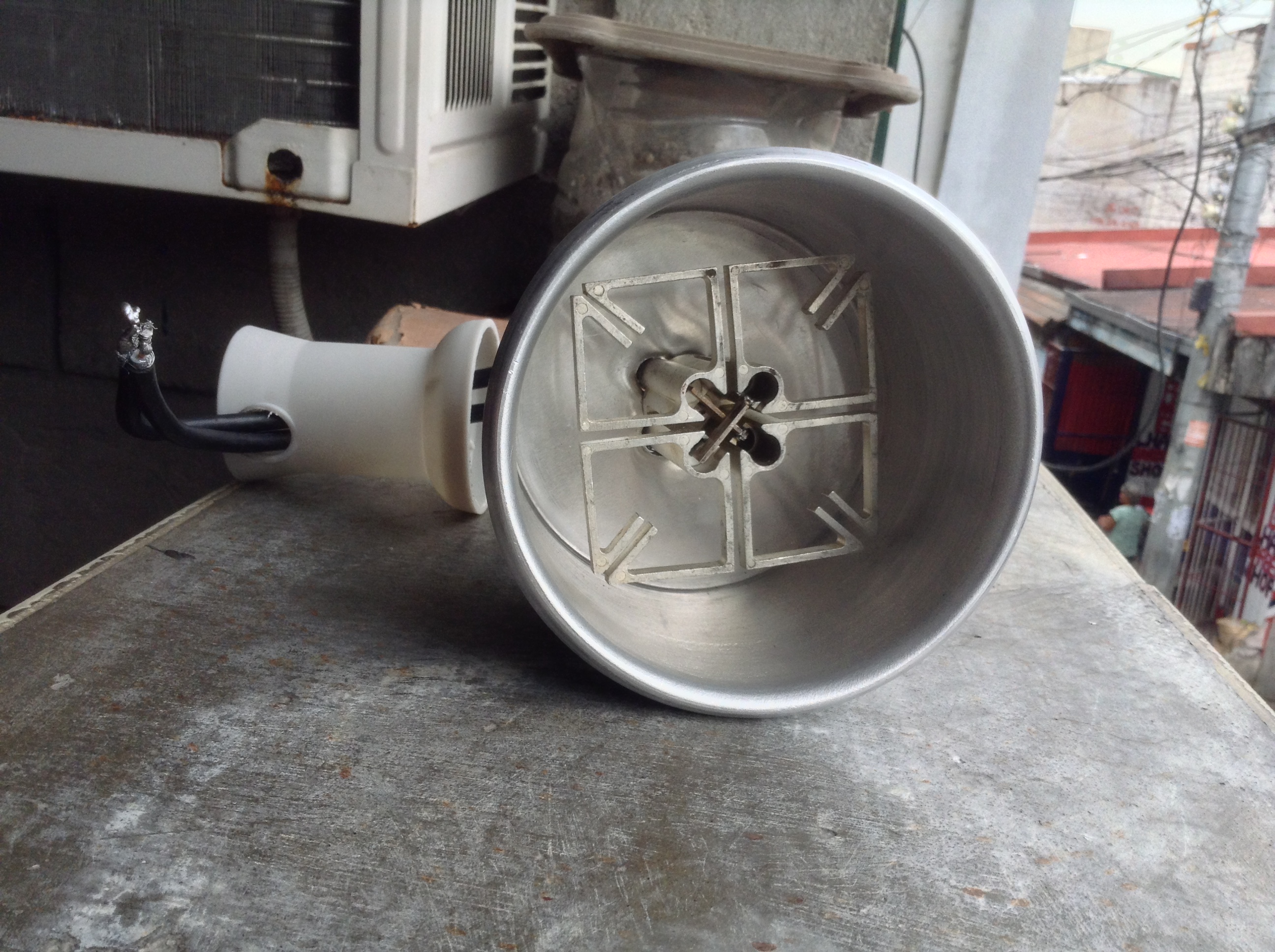

10 minutes ago, clanon said:SQUARE works too (aluminum plate RIVETED)...leave at least 1 cm to dipole borders...(my GUESS)

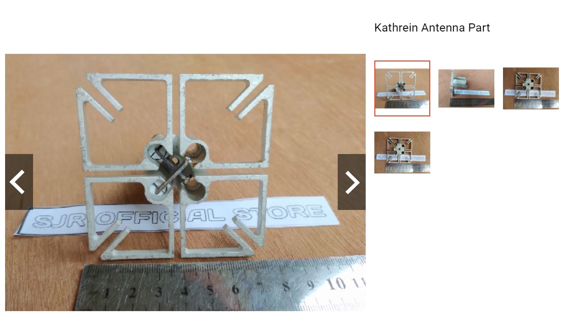

i am beginner and i just expore about this Kathrein antenna
Thanks to all your suggestions and share your idea i will follow it ,, i see new aluminum 4x3 pan i try this one

also i have another kathrein to try this one on picture1 person likes this -
6 hours ago, clanon said:The DIAMETER of the container ...is too small (dipoles are leaning-contact with container) apparently...(Which would give a jumping signal as it is seen , high and low swr , s11, impedance and changing diagram of radiation)
yup your right maybe i will search aluminum round as 3.5 or even 4 inch

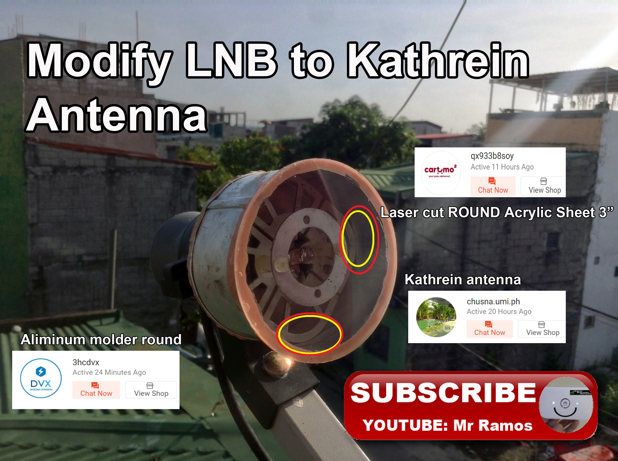

Good day ,, let me share my conversion satellite dish use by Kathrein antenna
I just modify LNB from satellite dish then I use aluminum puto mold 3inch and acrylic round plate 3 inch and put epoxy steel
I don't have a DIY tutorial
But it very easy to modify the LNB

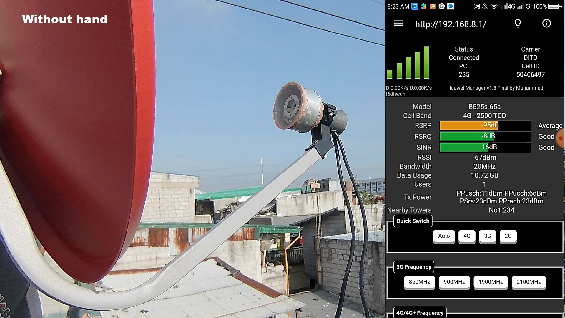

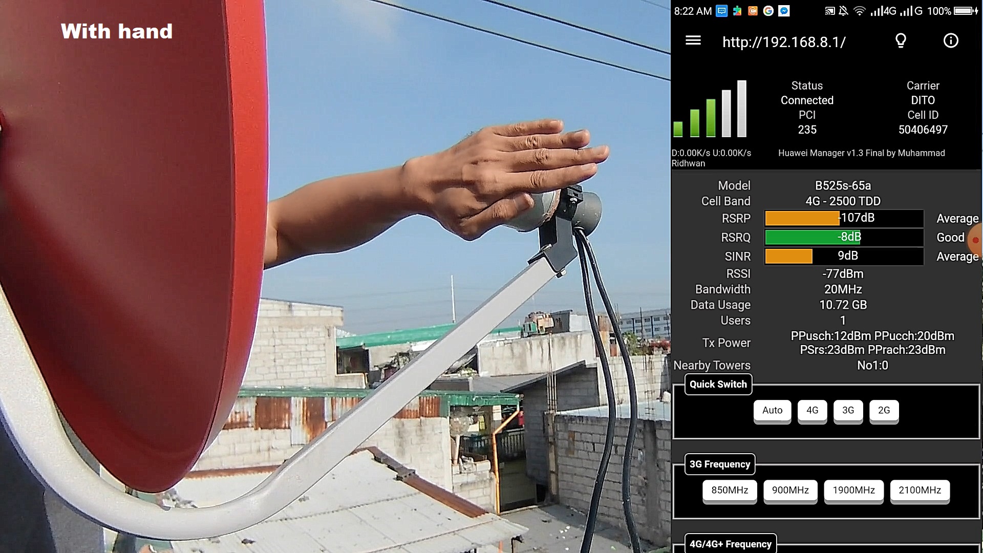

Testing if the signal reflect into Kathrein antenna LNB
Now speed test

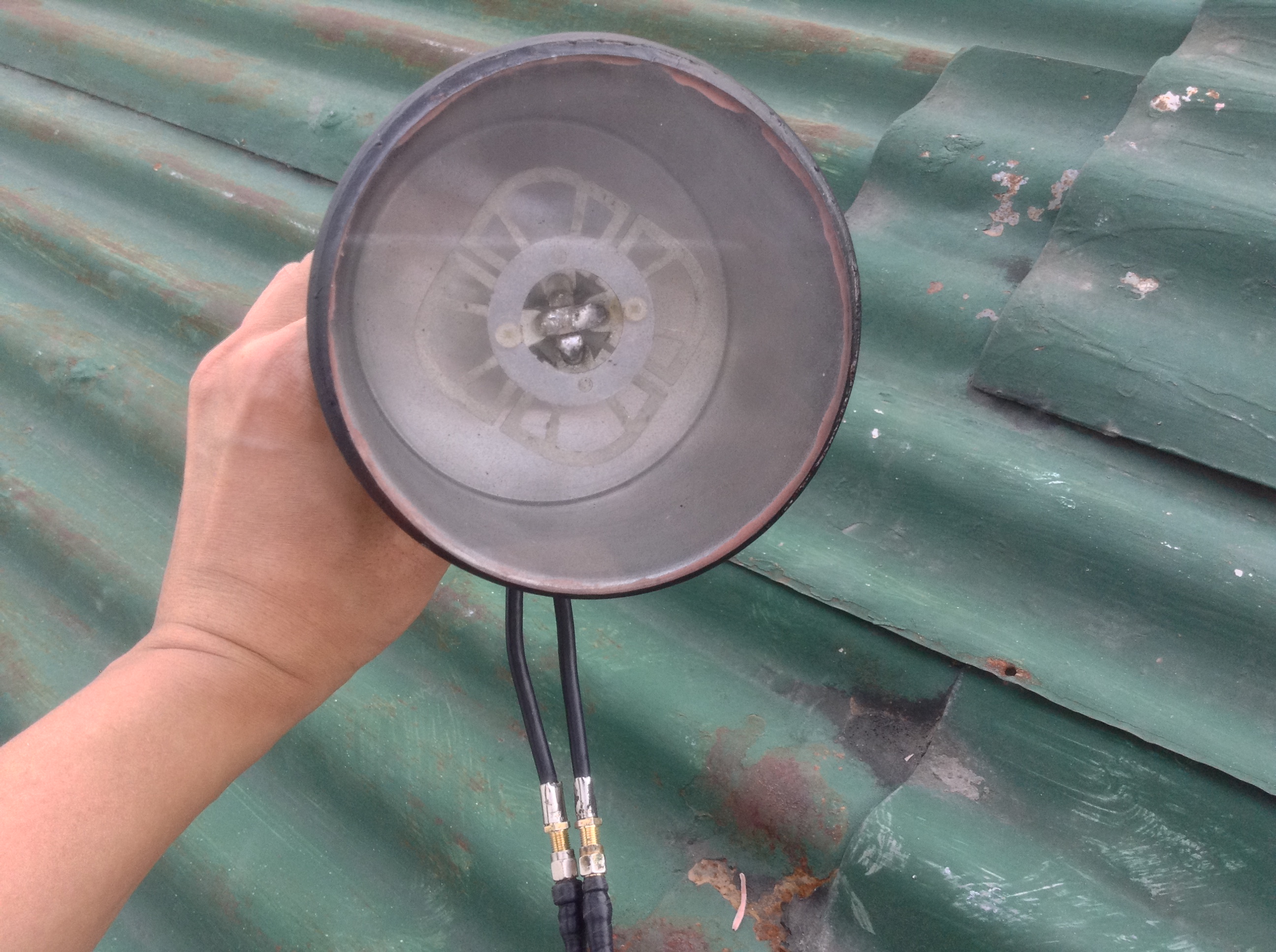

Final Lnb Modify
Aluminum pan 4 inch and 4.3 inch acrylic round plate
