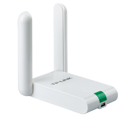

TP-link WN822N
Chipset Atheros AR9271
The interesting device is "full N 300 Mbps" how it is full I Hate, 2R2T . But the fact that he uses on the reception of both antennas it is a fact, try to put on the first antenna panel 18Dbi result is worse than with two pins.
Very good sensitivity , compared with a whistle at the base of Ralink - no worse.
Fully compatible with Commview.
In BackTrack5  and WifiSlax driver are - app.

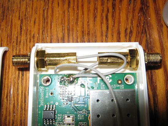

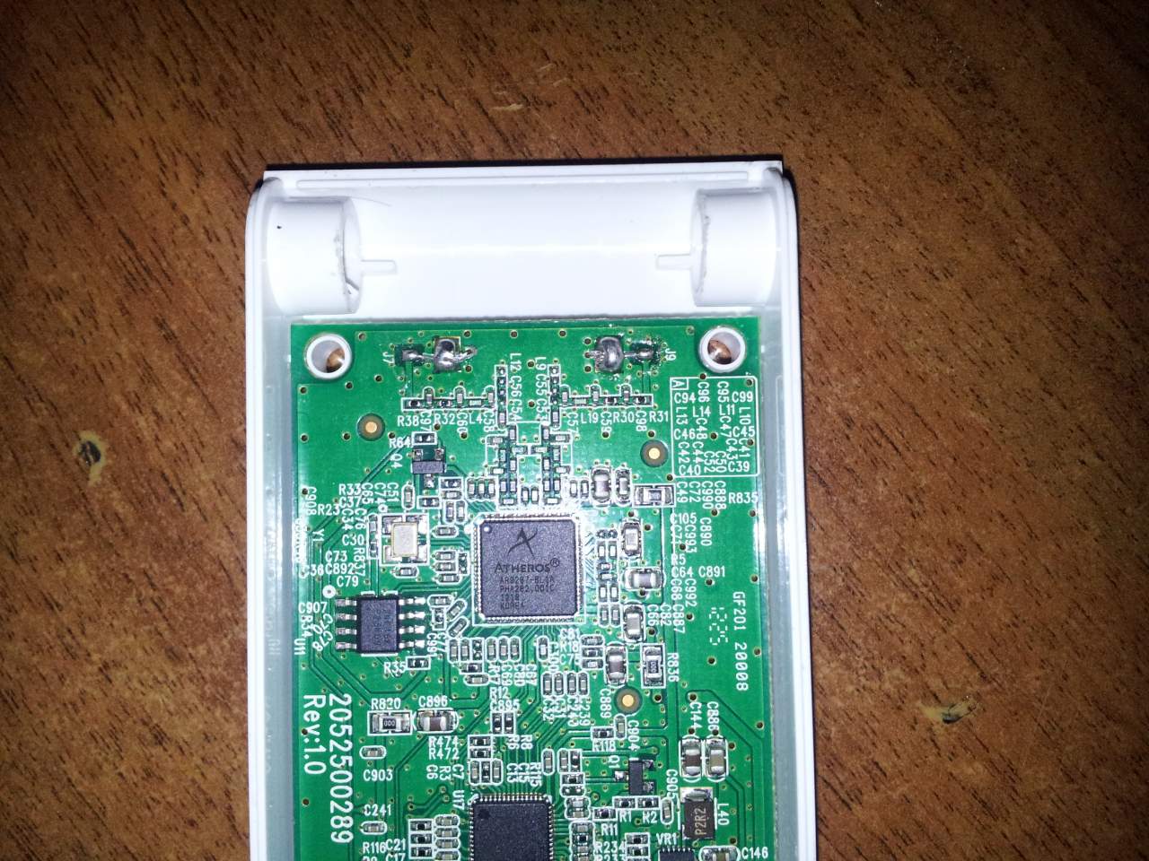

From slightly altered device: standard broke off the antenna ,put the connectors and soldered the cable to the antennas.
