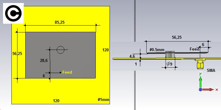

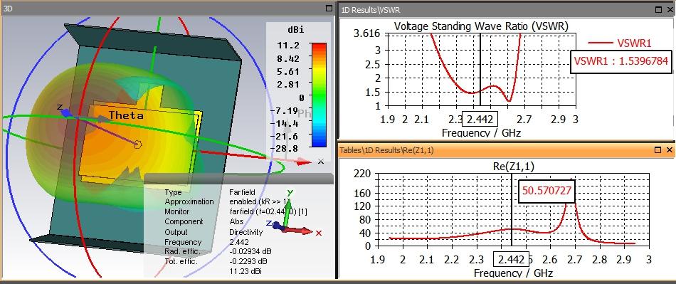

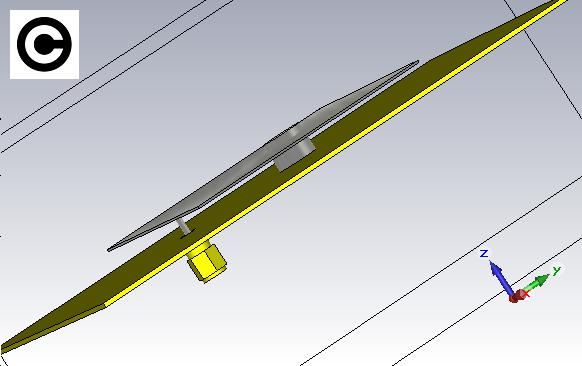

Pure Increased Patch (simple patch)
my junkies...
This is very good ... I think ... for offset parabolic...

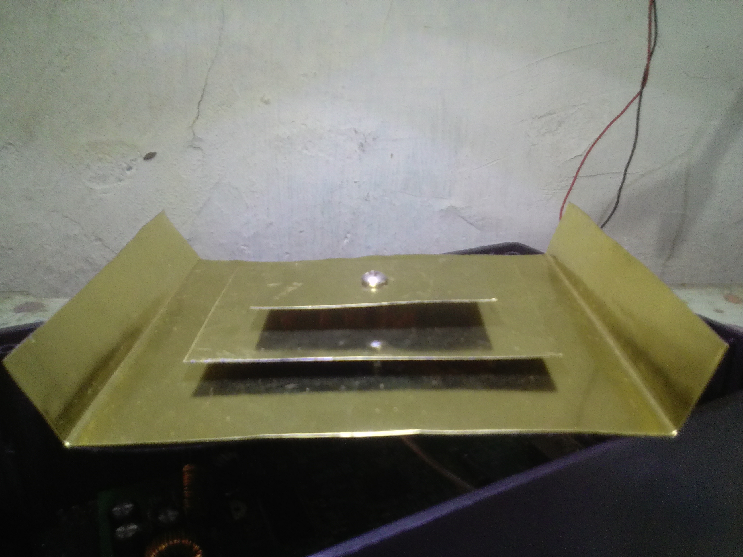

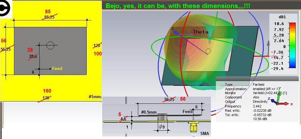

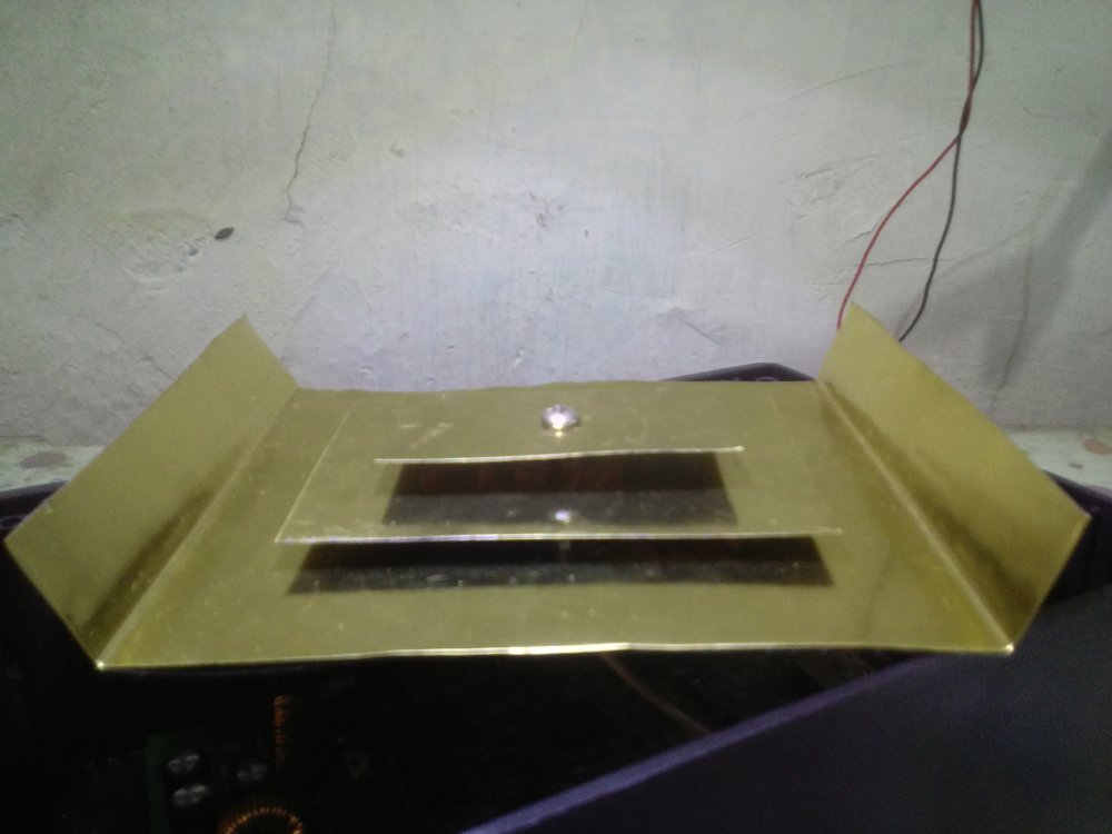

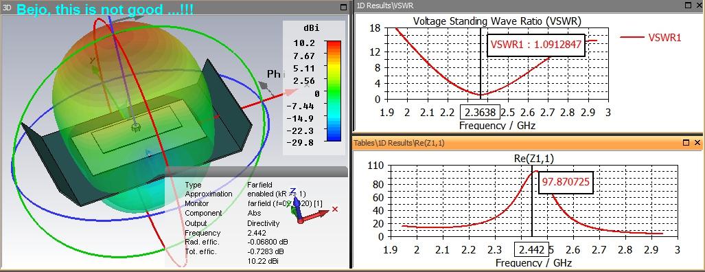

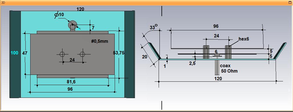

how about decrease a reflector, for fitting my outdoor box size 100x160mm
material from tin can 0.5mm, feed from coax cable
ok, but this is not mine ... !!!
i have made it, perhaps give more wireless range, not yet test :/:/
,,, you can put the sizes ...???
the other size is same as yours, except sma conn (replace with coax cable) dan material from tin can 0.5mm

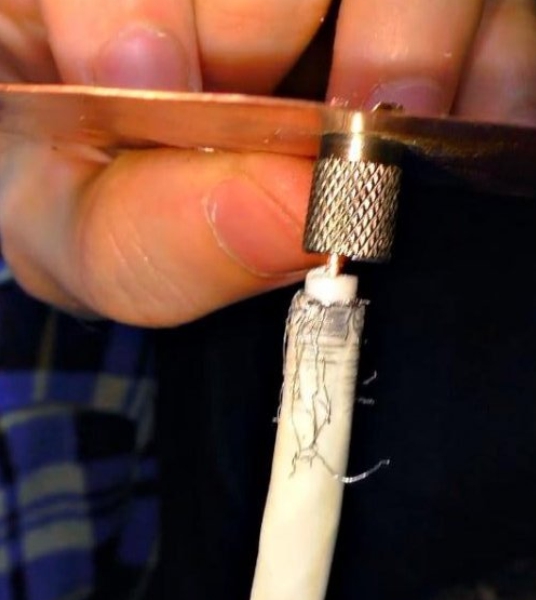

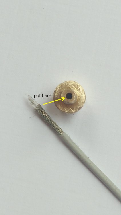

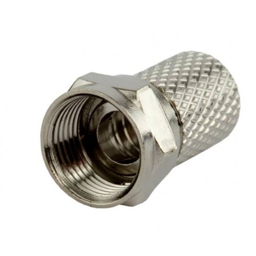

If you do not use a SMA connector, you should do this....
,,,with an external body jack TV...!!!
,,,it would be better...!!!
,,,or DB pure increased patch...
Another practical achievement...
,,,not,it must to calculate...!!!

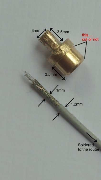

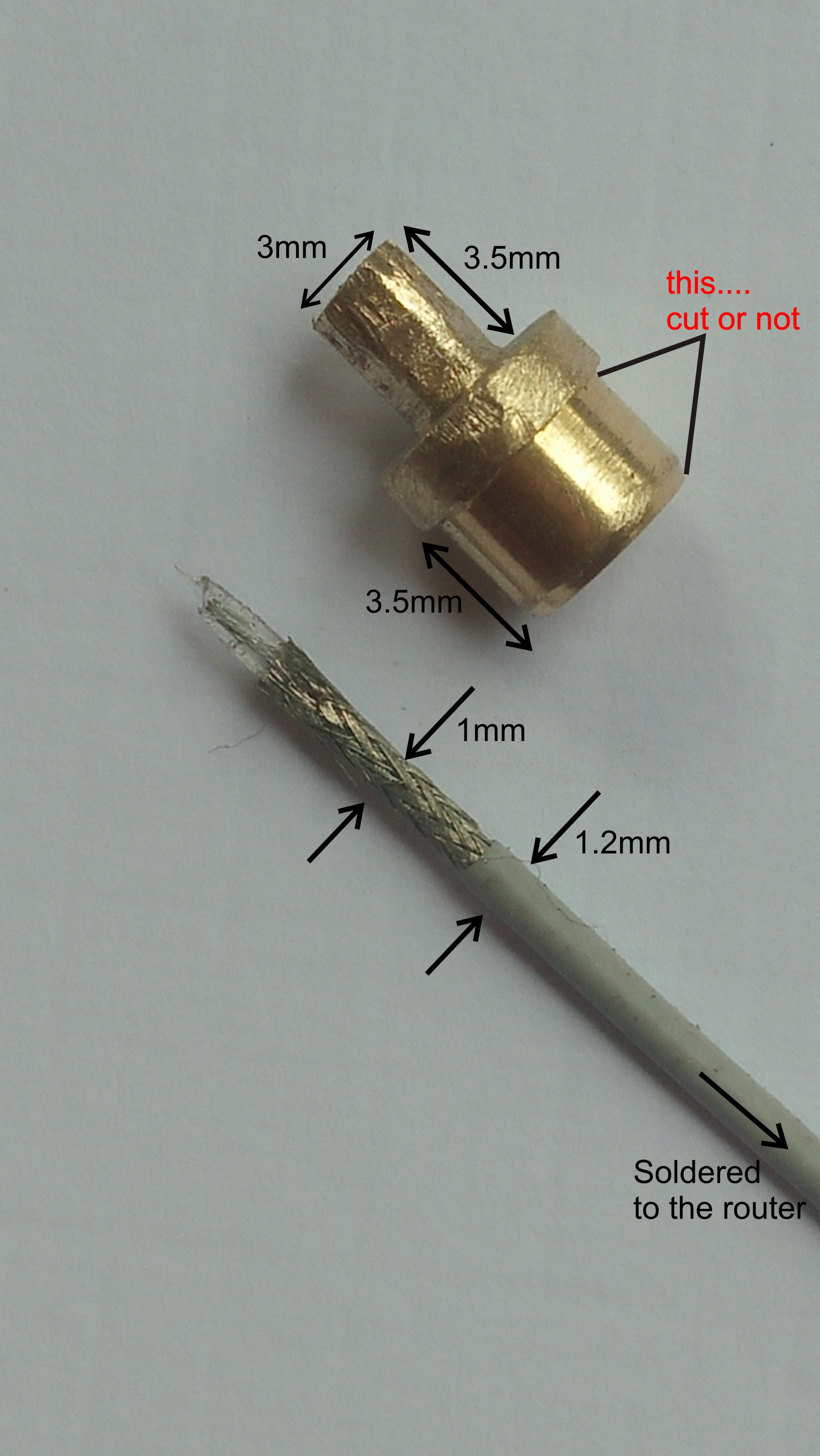

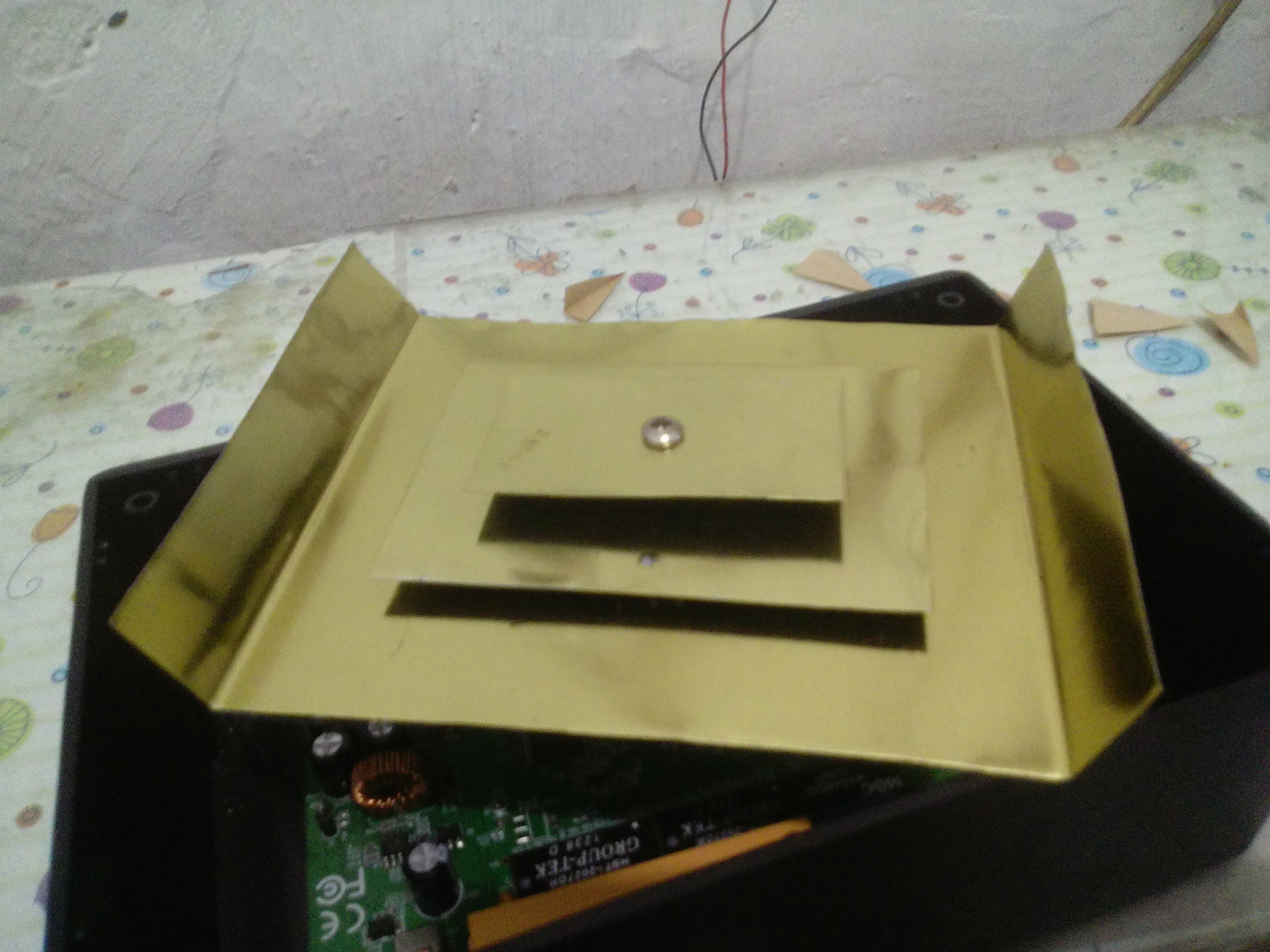

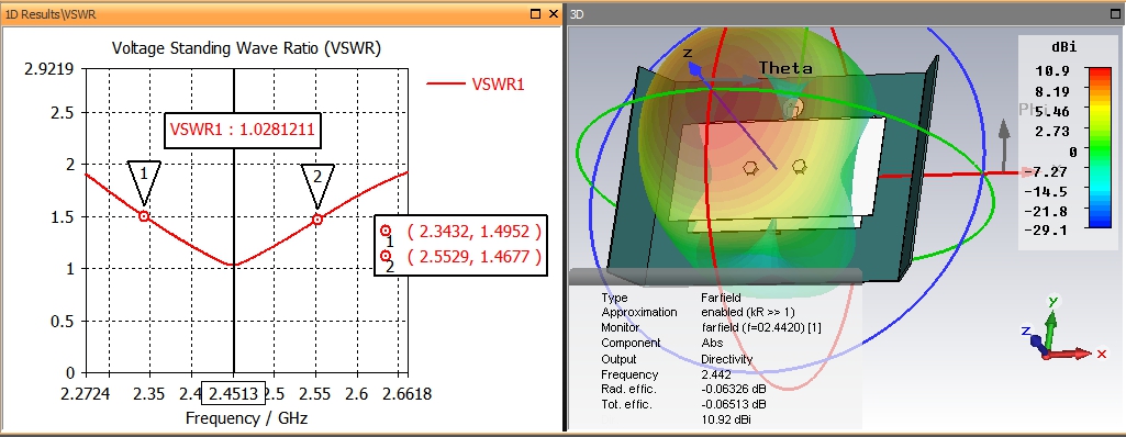

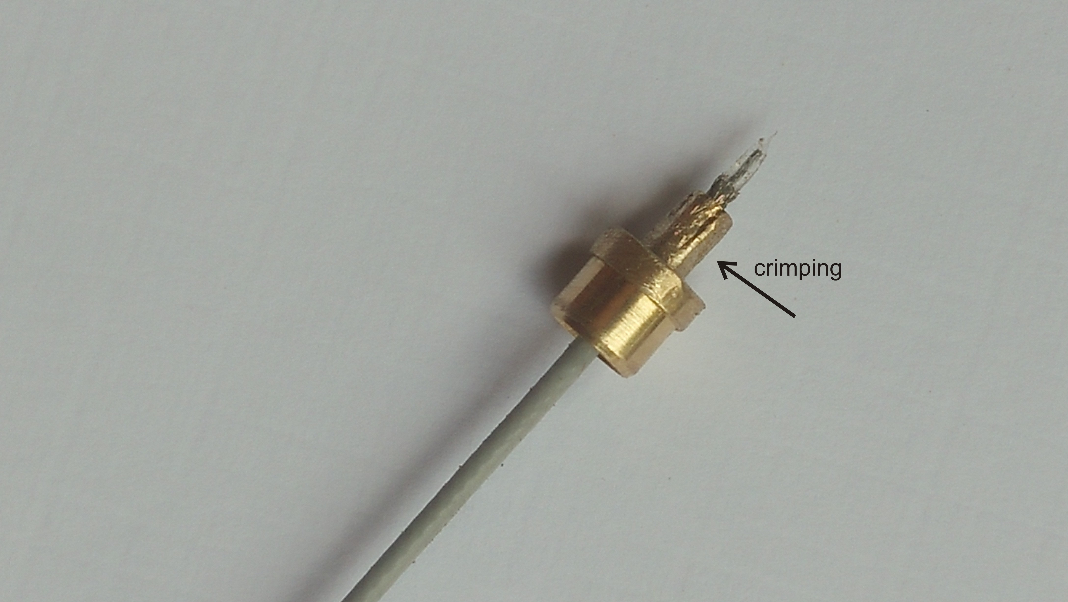

see image below.. it is right or not ??
No, it must to be checked...!!!
